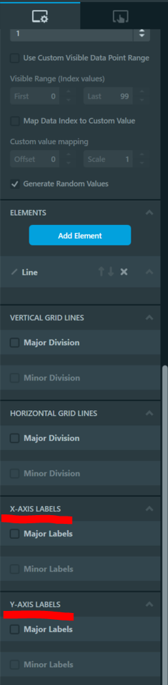

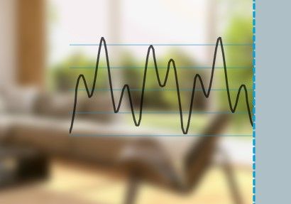

I'm using Dynamicgrapgh widget in TouchGFX to represent the sensor values graphically, i want to display the X and Y axis labels. I'm unable to get the labels on display UI even though i have enables Horizontal and vertical axis labels. Also how to write a function to update the sensor values on graph. Suggest me a solution

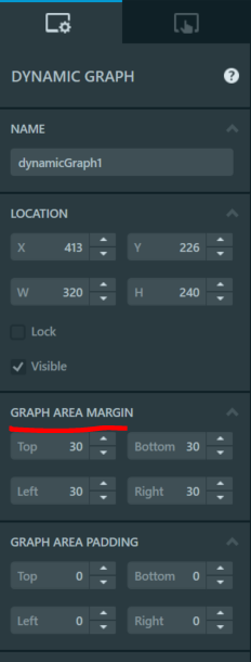

Could you share a screenshot of your graph configuration in TouchGFX Designer ? In the right tab there is an option to set the text for the label, you also have to set the "Graph area margin" section.

Mk.31
Hi Romain,
Thanks for sharing those details, now I'm able to see the y-axis labels on the UI.
I'm trying now to update the graph with sensor values.
/Megh
