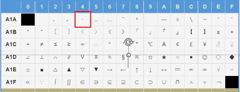

hello,
The special symbols to be used are marked in red below.
This is a special opportunity that cannot be entered on the keyboard, but it is a situation where you have to use this special symbol...
thank
Hello @mSH.1​ ,
If you want to use special characters, you have to be sure that the font you use supports them. To check that, you can take a look at this post.
Then, if you want to call a Unicode or ASCII characters by referencing its code, you can use wildcards and reproduce the step described here.
Hope that this helps,
/Yoann
