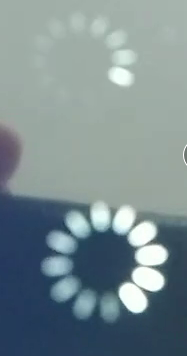

Texture Mapper with L8_ARGB8888 image would display shake when update Z-Angle.
2022-07-26 8:45 PM
Texture Mapper with L8_ARGB8888 image would display shake when update Z-Angle. But it works normally when used ARGB8888 image.
Are there any restrictions on using L8_ARGB8888 images?

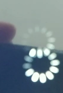

No improvement at all in version 4.20.0
The simulation runs properly, but it jitters when run on the MCU. (Texture Mapper used L8_ARGB8888 image would wobble whole screen when changed image angle.)

This phenomenon does not appear in the simulation.
I change the background from "box" to "box with border", it works normally.
It's confusing to me! I haven't made any changes except change the background widget.
It's working, but it's definitely a problem, and I want to get to the bottom of it.
