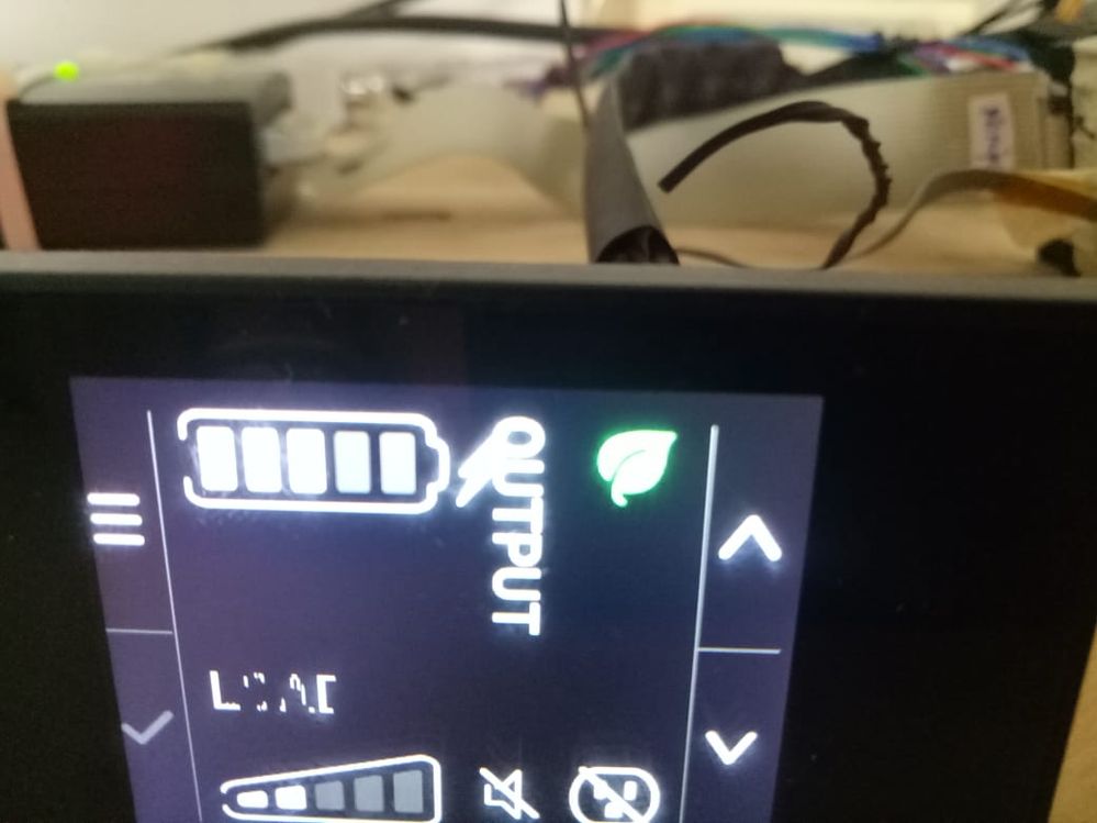

when I am rotating the text by 270 in setup screen() . From the handleTickEvent I am changing the wildcard text as well as I am also changing the position height and width though I am getting text but it is grainy...not clear(I have included invalidate() function also
Load in this Image0693W000005APuYQAW.jpg).I tried changing alpha and various height and width but still I am getting grains.....
AJT141
Can you share your code ?
Did you configure the MPU ? I had the same problem and now it is solved thanks ur
Here are some examples given by ST employee; just call this function in your main. Maybe it will need your modification - depends on frame buffer location !

RG.3
Yes I have Included MPU_config in main()....
The function is
void MPU_Config(void)

Gui code
void normal_screen_hView::setupScreen()
    ticks = 0;
    item_index = 0;
    load_index = 0;
    item_TypedText = T_INPUT;
    normal_screen_hViewBase::setupScreen();
    layoutScreenBase();
    refreshScreen(presenter->getScreenInfor());
void normal_screen_hView::refreshScreen(LCD_screen_t *LCD_screen)
  uint16_t i;
  Normal_t normal;
  switch(normal.index)
    case NormalMenuIndex_INPUT_VOLTAGE:
      Unicode::snprintf(normal_item_textBuffer, 30, "%s", TypedText(item_TypedText).getText());
       break;
    case NormalMenuIndex_OUTPUT_FREQUENCY:
            item_TypedText = T_OUTPUT;
            break;
    case NormalMenuIndex_OUTPUT_VOLTAGE:
      break;
    case NormalMenuIndex_RUN_TIME:
      item_TypedText = T_RUNTIME;
            break;
    default:
      break;
     item_text.invalidate();
    load_text.setTypedText(TypedText(T_LOAD));
    load_text.invalidate();
void normal_screen_hView::layoutScreenBase()
    icon_battery.setBitmap(Bitmap(BITMAP_BATTERY_03_WHITE_H_ID));
    icon_battery.setXY(    battery_icon_pos.y,
                        CONTAINER_SISE - battery_icon_pos.x - icon_battery.getHeight());
    container.add(icon_battery);
    icon_load.setBitmap(Bitmap(BITMAP_LOAD_02_H_ID));
    icon_load.setXY(load_icon_pos.y,
                    CONTAINER_SISE - load_icon_pos.x - icon_load.getHeight());
    container.add(icon_load);
    icon_audio.setBitmap(Bitmap(BITMAP_ICON_AUDIO_OFF_H_ID));
    icon_audio.setXY(    audio_icon_pos.y,
                        CONTAINER_SISE - audio_icon_pos.x - icon_audio.getHeight());
    container.add(icon_audio);
    icon_plug.setBitmap(Bitmap(BITMAP_ICON_PLUG_OFF_H_ID));
    icon_plug.setXY(plug_icon_pos.y,
                    CONTAINER_SISE - plug_icon_pos.x - icon_plug.getHeight());
    container.add(icon_plug);
    icon_charging.setBitmap(Bitmap(BITMAP_ICON_CHARGING_WHITE_H_ID));
    icon_charging.setXY(charging_icon_pos.y,
                        CONTAINER_SISE - charging_icon_pos.x - icon_charging.getHeight());
    container.add(icon_charging);
    icon_status_online_green.setBitmap(Bitmap(BITMAP_ICON_STATUS_ONLINE_GREEN_H_ID));
    icon_status_online_green.setXY(    status_online_green_icon_pos.y,
                                    CONTAINER_SISE - status_online_green_icon_pos.x - icon_status_online_green.getHeight());
    container.add(icon_status_online_green);
    item_text.setPosition(75,12,46,226);
    item_text.setColor(touchgfx::Color::getColorFrom24BitRGB(204, 204, 204));
    item_text.setLinespacing(0);
    item_text.setRotation(TEXT_ROTATE_270);
    normal_item_textBuffer[0] = 0;
    item_text.setWildcard(normal_item_textBuffer);
    item_text.setTypedText(TypedText(T_NOR_ITEM));
    container.add(item_text);
    load_text.setPosition(155,12,31,150);
    load_text.setColor(touchgfx::Color::getColorFrom24BitRGB(204, 204, 204));
    load_text.setLinespacing(0);
    load_text.setRotation(TEXT_ROTATE_270);
    normal_load_textBuffer[0] = 0;
    load_text.setWildcard(normal_load_textBuffer);
    load_text.setTypedText(TypedText(T_NOR_LOAD));
    container.add(load_text);
I am calling refresh screen function from handle tick event....(For every 2 seconds)

Thanks a lot! It worked....
AJT141
Hmm you have to test with different MPU configs (i gave you more than one configuration but I agree that is was not clear).
Just select one config between two
HAL_MPU_ConfigRegion(&MPU_InitStruct);
because currently you are just testing the last configuration of the 5 configurations i gave you.
For me, this configuration fixed my problem (especially the MPU_ACCESS_NOT_BUFFERABLE value) :

You can also try to invalidate the whole background and check if it solve the issue.
Can you tell me why Normal_t normal is not initialized ? do you always go in the default case ?
Can set a breakpoint on item_text.invalidate(); line code and check if you are going to display the correct string ?

Configuration 2 worked for me....that Normal_t is declared in other C file. I understood what u are trying to explain....Thanks a ton for your timely help.
