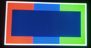

I want to display 2 images in a screen, but it only display 1 image when used IAR to generate code. The project does not make any changes and generates code in KEIL, then it succeeds.
 (The code optimizations is none and CSTACK / HEAP space is large enough in IAR.)

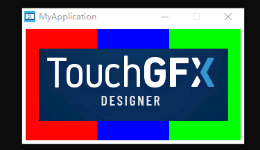

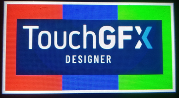

Below is the problem I encountered:
(Here are 2 images to displayed, RGB background image and Logo image.)
1) Touchgfx simulator:
2) Keil Project Effect:
3) Iar Project Effect:
I used STM32CubeMX + TouchGFX Designer V4.17 to generat code, all the codes are the same except scatter load file:

Hi Romain,
A bug was found in my IAR flashloader, issue was settled when fixed it.
Thank you!:beaming_face_with_smiling_eyes:
