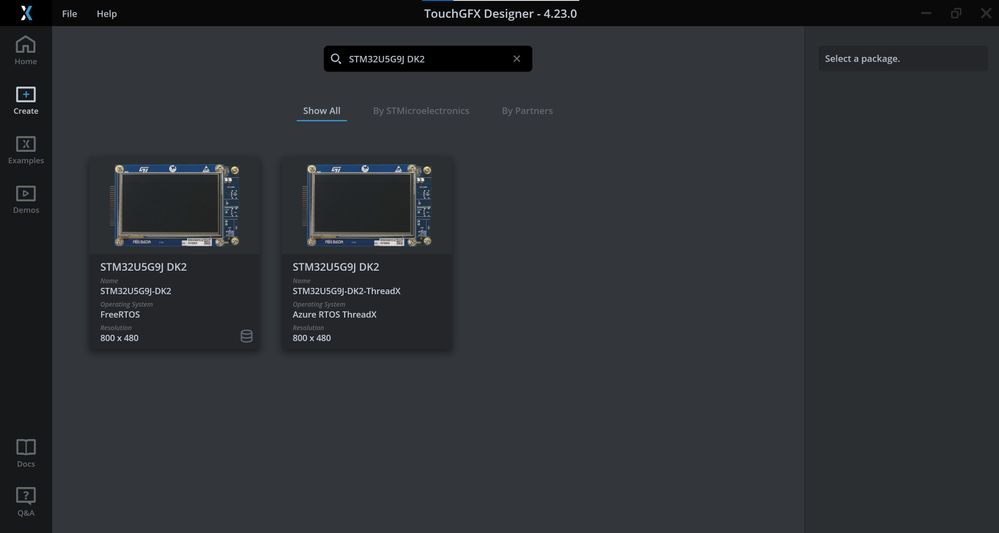

Does the STM32U5G9J-DK2 and the pending STM32U5G9J-DK1 kit support inside of TouchGFX offer the vector graphics features?
Is the vector graphics support natively enabled if using either of these kits?
Thanks again.
Yes, they do. Both will have NeoChrom graphic accelerator which helps a lot with vector renderings. And, this feature is enabled on the STM32U5G9J-DK2 available on TouchGFX.
STM32U5G9J DK2 Board SetupSTM32U5G9J DK2 Board Setup
You can read more about vector rendering here

1) The linked article notes that only the IAR toolchain is supported at this time. To confirm, IAR is required to develop with the STM32U5G9J-DK2 kit?
2) The landing page at Mouser.com does not show the STM32U5G9J-DK2 with a LCD. Would you please confirm that the LCD is included in the kit?

1) No, You can use any other compiler for developing. IAR was the first toolchain to support it, but now you can use IAR, STM32CubeIDE, and MDK-ARM for development.
2) Yes, STM32U5G9J-DK2 has a 800*480px display.
