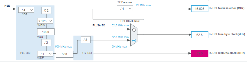

I have 32L4R9IDISCOVERY board with round display. When I set clock configuration of MIPI DSI there is one error. DSI rxclkesc is same as DSI lane byte clock if lane_byte_clock is fed from DSI-PHY.
For 32F469IDISCOVERY DSI clock setting there is no rxclkesc (i think it should be same as txclkesc).
I want to use DSI-PHY clock for lane byte clock. Whats wrong ?
Thanks
EDIT: I am using STM32CubeMX version 5.1.0.
