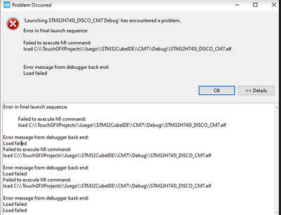

I have a STM32H745i that if I want to load the code by USB it works OK if the project is from STM32CubeIDE (1.16.0) but if the project is imported from TouchGFX it presents the following error when I want to load the code:
I read a post from someone who had this error but I don't understand the “ExtMem_Boot” step so I just set up the external loader but it didn't work.
any idea what it could be?

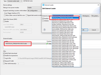

I reproduced the behavior and seems you didn't select the correct External Flashloader:
The correct one is: MT25TL01G_STM32H745I-DISCO.stldr
I was able to upload the external QSPI after setting correct flash loader.
Hope it does answer your question.

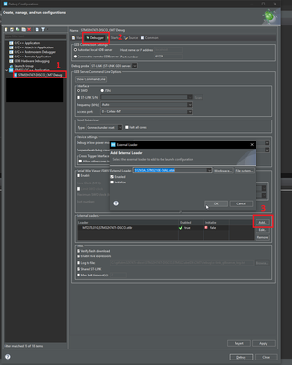

It seems you have not mentioned the file to use as external loader.
This can be easily fixed.
  1. Open STM32CubeIDE
  2. Right click on your project
  3. Go to Debug as
  4. Click on Debug configurations...
  5. Select your project again
  6. Open the Debugger window
  7. Under External loaders, click on Add
  8. Browse to find your stldr file (usually located in the gcc folder)
This should fix your problem.

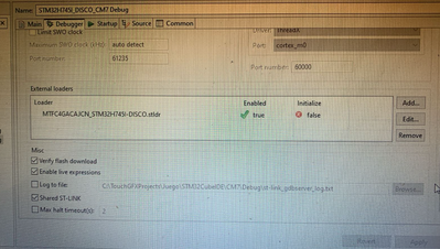

Good morning Gaetan and thank you for your reply,
I had tried what you mentioned but it doesn't seem to work, I don't know if you meant that the file is inside the project folder. I selected the one that seemed right for my model from the options that the compiler gives me, it looks like this:
but it throws the same error.
The steps followed were two.
1) first I tried exactly what the following video shows:
https://www.youtube.com/watch?v=Tkz9099a7a4
(in short it only compiles the project and opens it to be imported to stmcubeide and then load it without changes to the configuration.
2) when it didn't work I followed exactly the steps that worked for the previous project that I did with leds that didn't use touchGX but it didn't work either.
https://www.youtube.com/watch?v=jI1k6p-fduE
(following the steps as they were in the minutes (8:50 to 14:50))
3)I had read some of what you mentioned and tried to put external loader but for some reason it doesn't want to load the code either.
