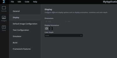

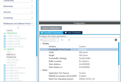

I have tried TouchGFX and i need some tools from squareline studio that not exist in touchgfx, so i choose touchgfx. basically it is mostly the same. How can i change 32 depth to 16 in touchgfx? what should i change?
Osman SOYKURT
Hello @BAl K.1 ,
In TouchGFX that's pretty simple actually, it uses the Framebuffer Pixel Format you set in the STM32CubeMX project (You need to have the X-CUBE-TOUCHGFX software pack of course).
In the "Config" panel in TouchGFX Designer, you'll see then the Color depth associated to it, and whenever you'll generate code, it will take in account that value.
