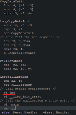

So Im trying to move heap to my external SDRAM and the problem is that it hardfaults after 3s and do not know why.
In startup file before__libc_init_array i call fmc function which init SDRAM.Fmc function looks like this:

Im using TouchGFX, STM32H743ZIT6 and IS42S16400J-6TLI SDRAM. Ive already changed my sbrk, linker and MPU. I add code fragments:

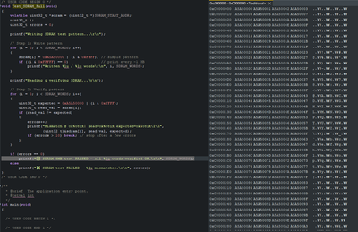

Yes, now I tested all 8MB SDRAM and everything works as expected.

You need to debug that fault, I think you have an access to a memory region that is prohibited by that MPU config. So you need to add that region to the MPU config.
Does it important to initialize fmc inside systemInit()? or can initialize fmc later
Here, before libc_init_array
You need to initialize the FMC before calling the main().
So initialize it in SystemInit(). You can inspire from the HAL implementation especially system_stm32h7xx.c located in any example folder https://github.com/STMicroelectronics/STM32CubeH7/tree/master/Projects/STM32H743I-EVAL/Examples
But i also need to initialize HAL_Init(); because FMC using HAL library, so now Im added to SystemInit and it hardfaults immediately. When I call later then is no hardfault, i mean before libc_init_array
You need to use direct access to the registers. As I said inspire from the SystemInit() implementation in the HAL:
see how  SystemInit_ExtMemCtl() has been implemented. It's called inside SystemInit():
#if defined (DATA_IN_ExtSRAM) || defined (DATA_IN_ExtSDRAM)
  SystemInit_ExtMemCtl();
#endif /* DATA_IN_ExtSRAM || DATA_IN_ExtSDRAM */
DATA_IN_ExtSDRAM to activate the access to the SDRAL and DATA_IN_ExtSRAM is to activate the access to the SRAM to that board.
So you need to adapt the GPIOs, the clocks and the the FMC config in SystemInit_ExtMemCtl() based on your what you have in your board.
Don't forget to disable the FMC init from CubeMx in that case as the FMC was already initialized in SystemInit().
