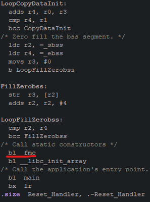

So Im trying to move heap to my external SDRAM and the problem is that it hardfaults after 3s and do not know why.
In startup file before__libc_init_array i call fmc function which init SDRAM.Fmc function looks like this:

 Does someone sees where is the problem? Or what to check?
You need to use direct access to the registers. As I said inspire from the SystemInit() implementation in the HAL:
see how  SystemInit_ExtMemCtl() has been implemented. It's called inside SystemInit():
#if defined (DATA_IN_ExtSRAM) || defined (DATA_IN_ExtSDRAM)
  SystemInit_ExtMemCtl();
#endif /* DATA_IN_ExtSRAM || DATA_IN_ExtSDRAM */
DATA_IN_ExtSDRAM to activate the access to the SDRAL and DATA_IN_ExtSRAM is to activate the access to the SRAM to that board.
So you need to adapt the GPIOs, the clocks and the the FMC config in SystemInit_ExtMemCtl() based on your what you have in your board.
Don't forget to disable the FMC init from CubeMx in that case as the FMC was already initialized in SystemInit().

I call fmc here:
Yes, as I said when I upload code it start up and if I do not go to another screen it works perfectly fine, but when Im trying to do that it hardfault after uploading next screen view. During loading screen it creating objects
