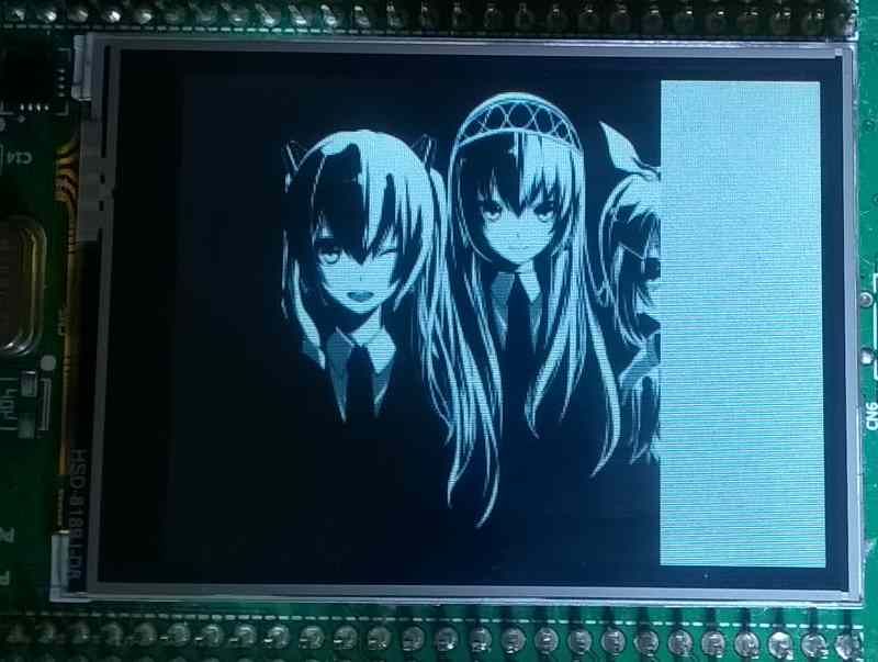

Good morning,
i have a problem with display orientation, i have changed the ili9341 register and the image rotate correctly but, i have a white portion of the display of 80 column in the side of the display.the LTDC registers are /* Configure horizontal synchronization width */ LTDC_InitStruct.LTDC_HorizontalSync = 9; /* Configure vertical synchronization height */ LTDC_InitStruct.LTDC_VerticalSync = 1; /* Configure accumulated horizontal back porch */ LTDC_InitStruct.LTDC_AccumulatedHBP = 29; /* Configure accumulated vertical back porch */ LTDC_InitStruct.LTDC_AccumulatedVBP = 3; /* Configure accumulated active width */ LTDC_InitStruct.LTDC_AccumulatedActiveW = 349; /* Configure accumulated active height */ LTDC_InitStruct.LTDC_AccumulatedActiveH = 243; /* Configure total width */ LTDC_InitStruct.LTDC_TotalWidth = 359; /* Configure total height */ LTDC_InitStruct.LTDC_TotalHeigh = 247;any solution?Thank you. #stm32 #lcd #discovery #tft #tft-ltdc-display-landscape- Labels:

Been trying to do the same, but the same results.
Steps:1. Change dimensions in header2. Change column/row address order in MAC register3. Change the LDTC as above4. Change the LCD Layer tooSeem to be getting the same unwritable 80 pixel column on the right.I guess it is all to do with the correct combination of above settings.It would also appear that there is a bit too much reliance in the LCD dimension definitions in the code.- Mark as New

Hello!
I have same problem. On the right side is white area.In ILI9341:I changed register 0x36 value (Row/Column exchange) and start/end address for Column and page (register 0x2A and 0x2B).In STM32F429 LTDC:#define
LCD_HSYNC 0x0A // 10#define
LCD_HBP 0x14 // 20#define
LCD_HAREA 0x140 // 320#define
LCD_HFP 0x0A // 10#define
LCD_VSYNC 0x02 // 2#define
LCD_VBP 0x02 // 2#define
LCD_VAREA 0xF0 // 240#define
LCD_VFP 0x04 // 4#define
HSW (LCD_HSYNC - 1)#define
AHBP (LCD_HSYNC + LCD_HBP - 1)#define
AAW (LCD_HSYNC + LCD_HBP + LCD_HAREA - 1)#define
TOTALW (LCD_HSYNC + LCD_HBP + LCD_HAREA + LCD_HFP - 1)#define
VSH (LCD_VSYNC - 1)#define
AVBP (LCD_VSYNC + LCD_VBP - 1)#define
AAH (LCD_VSYNC + LCD_VBP + LCD_VAREA - 1)#define
TOTALH (LCD_VSYNC + LCD_VBP + LCD_VAREA + LCD_VFP - 1)// LCD Synchronous timing
LTDC->SSCR = HSW << 16;//Horizontal Synchronization Width
LTDC->SSCR |= VSH;// Vertical Synchronization Height
LTDC->BPCR = AHBP << 16;// Accumulated Horizontal back porch
LTDC->BPCR |= AVBP;// Accumulated Vertical back porch
LTDC->AWCR = AAW << 16;// Accumulated Active Width
LTDC->AWCR |= AAH;// Accumulated Active Height
LTDC->TWCR = TOTALW << 16;// Total Width
LTDC->TWCR |= TOTALH;// Total Height
And the result is:#define
LCD_VAREA
0xF0
+80
// 240+80 = 320
I got:- Mark as New
