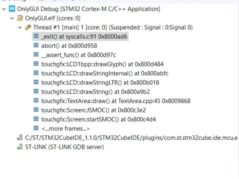

I'm trying to get TouchGFX working on a STM32F401RE device with a 200x200 screen.
I've created a simple project with one screen and text as 1bit color depth (Idither_algorithm := 2, opaque_image_format := BW, non_opaque_image_format := BW on app.mk) and I use these configuration on BoardConfiguration.cpp:

I think that framebuffer big is enough for a 1 bit per pixel ( 200 * 200 / 8 bytes). Everything compiles OK but at debug system crashes always when trying to draw at touchgfx::LCD1bpp::drawGlyph()
I've seen other examples and they always use uint16 [width *height] arrays for creating the frame buffer, but this should only be needed in case of 16BPP. Its also needed for working with 1BPP? If not, what's happening?

I've found the origin of the error. Despite configuring my TouchGFX as 1bpp, when text is added the default font is set as 4bpp, that was the origin of the error.

Hi Martin,
I've changed the project to a 175x175 in order to get a uint16_t framebuffer that fits in the inner RAM and I stll get the same error, so it does not seem to be some memory overflow problem.
Here I attach you the image of the current function where my code gets stuck (exit() function in syscall after LCD1bpp:drawGlyph())

Sorry Martin,
It was an error from my side, the project wich I was working had an empty screen, that's why there was no error on glyph. But now I've added text to it and its crashing again.
It crashes on LCD1bpp::drawGlyph() inside __assert_func()
