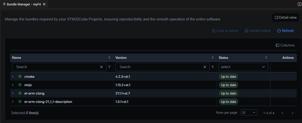

vincent_grenet
@ANeam.1
Please be aware STM32Cube bundle st-arm-clang@21.1.1+st.7 delivered today is fixing issue.
Please have a try updating and locking proper version to your project:
Additional information about the fix is detailed here in @FluxPower42 's thread.
