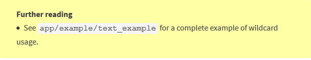

The documentation is severely lacking. Where are the referenced code examples from the Draupner website? They do not appear to be posted inside the 4.10 toolchain.
ie. from
https://touchgfx.zendesk.com/hc/en-us/articles/207015345
https://touchgfx.zendesk.com/hc/en-us/articles/207015345-Using-texts-and-fonts
Where can the following reference example be found? Guessing it is no longer supplied in the current distribution.
This toolchain requires complete and concise code examples of "how to".
A good product manual should have started with a simple "Hello World" but instead, came across C++ functions:
https://www.touchgfx.com/documentation/html/index.html
How about full examples on how to use each of these functions?

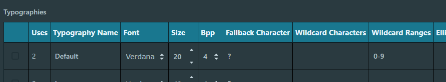

To achieve this, your typography must know about a range of possible outcome values - So in this case where we'll be incrementing a value from 0 a range of 0-9 is the right setting.
