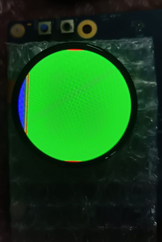

I successfully got a display displaying the actual GUI but it is slightly shifted from the left and from upper and bottom side as well

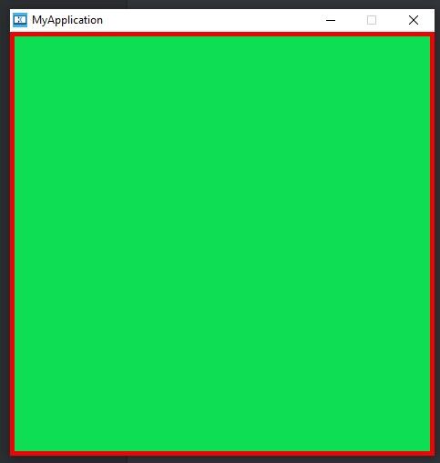

I am attaching images here; the first image is the simulator, and the second is the actual display.
Simulator Image:
Actual Hardware:

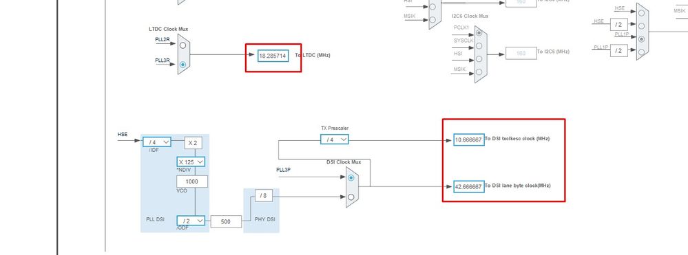

My configuration for clocks are as  given below

I solved the issue by changing my LTDC clock to 21.33 MHz and DSI clock to 42.666 Mhz.
A suggestion from @MM..1 really helped me to get the display working.

Hello, have you tried changing line 68 of ltdc file? This sets the start column.
Start basic frame without TGFX run. And correct DSI config
  VidCfg.HorizontalSyncActive = 1;
  VidCfg.HorizontalBackPorch = 1;
  VidCfg.HorizontalLine = 466;
this numbers require be in DSI clock counting, no video clock as LTDC. For example if LTDC dotclock is 20MHZ and DSI data clock is 60M all this require multiply 60/20= x3   usw.
Too exist helping func for start pattern on DSI ... HAL_DSI_PatternGeneratorStart(&hdsi,0,1);

#define LTDC_CLK_KHZ 21333
#define DSILANE_CLK_KHZ 42667
