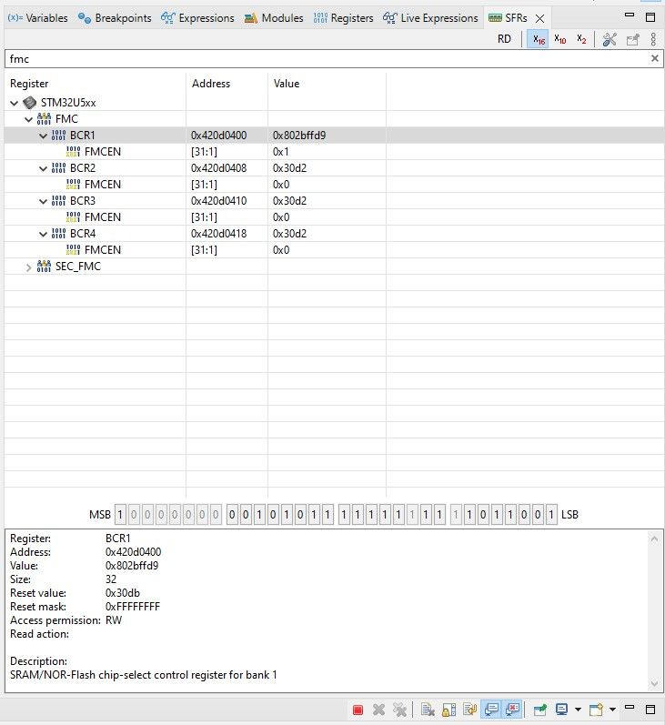

I'm struggling with a TFT Display and a Nucleo U575 board. The Display is a 320x240px Display that I want to control with a 16 bit FMC interface.
As the Display doesn't show anything, I connected my Logic analyzer to the Nucleo's FMC Pins.
Result: It seems, that the commands (8-bit) are sent correctly to the TFTs D0:D7 pins. However when I try to send data (e.g. a 16 bit color) to the display it's also just D0:D7 that turn high/low. D8:D15 are always low when data is sent and are always high wen nothing is sent.
I followed this guide by NickNagy on github. He's using a 8-bit interface. However I changed to the 16-bit command for sending data and I can't find the mistake I obviously made.

‎2022-05-28 6:28 AM
I'm not quite sure if I got the things you mean as I'm quite new to the Cube environment, but I hope I found the correct data :) If not, please let me know...

I think you got me wrong here: When scoping the lines, I don't get valid data:
- lines 0-7 are oscillating in a way. However I can't find the correct bit sequence (e.g. 00010001 for the command sleepout) but different "random" values.
- lines 8-15 are always low. When sending a command this might be right as it's an 8-bit command, but they are also low when sending (16-bit) data. Doesn't matter if I send 0xFFFF or 0x00 the output for lines 8-15 are always scoped low.
That's why I was wondering about the address...
