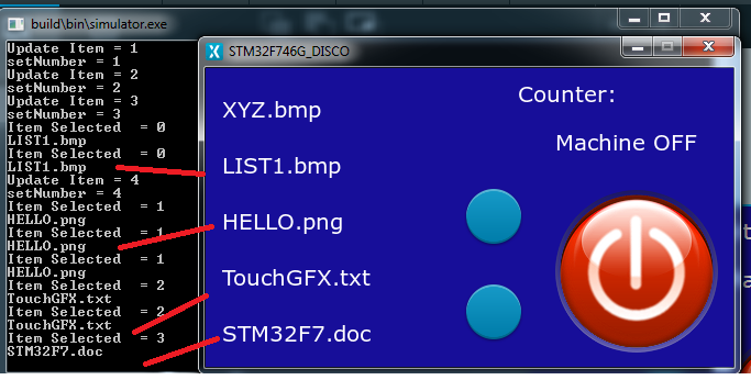

I want to know:
1) Is the right method ?
2) How to Select/Highlight File Name once item is clicked .
and send Selected item (File name) to touchgfx_print windows?
3) How to add/remove the Element (File Name) from List from some other button ?
Please see short video..

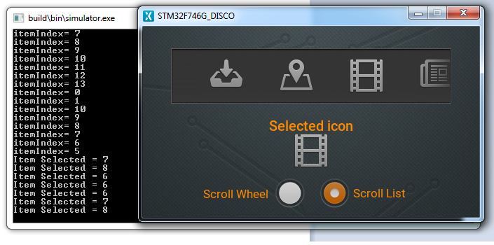

I think Scroll Wheel and List Example v1.0.0 . is more suitable and easy implementation for my requirement as I am quite close to that also .
I have tested on Simulator that item is select as well . Please check below screenshort.
https://community.st.com/s/question/0D50X0000Bed8tjSQA/scrolllist-item-selection
The video attached by member seems should work as my requirement also .
https://community.st.com/s/question/0D50X0000B09SiC/visible-items-in-scrolllist
Same by this member .

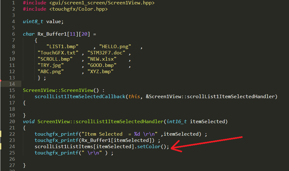

I corrected the code below (missing one initialization) and add some comments.
#include <gui/screen1_screen/Screen1View.hpp>
Screen1View::Screen1View() :
	    scrollList1ItemSelectedCallback(this, &Screen1View::scrollList1ItemSelectedHandler)
void Screen1View::setupScreen()
	  Screen1ViewBase::setupScreen();
        // Is the a right  ? Yes
       scrollList1.setItemSelectedCallback(scrollList1ItemSelectedCallback);
void Screen1View::scrollList1ItemSelectedHandler(int16_t itemSelected)
	touchgfx_printf("Item Selected = %d \r\n" ,itemSelected) ;
        /* You need to do the changes in the custom container you created for this scroll List.
           Then you call the function that changes the color and that is implemented in your customContainer */

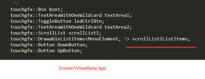

You can change the color like as follows:
scrollList1ListItems[itemSelected].setColor();
ScrollList1ListItems should be declared in Screen1ViewBase.hpp
/Alexandre

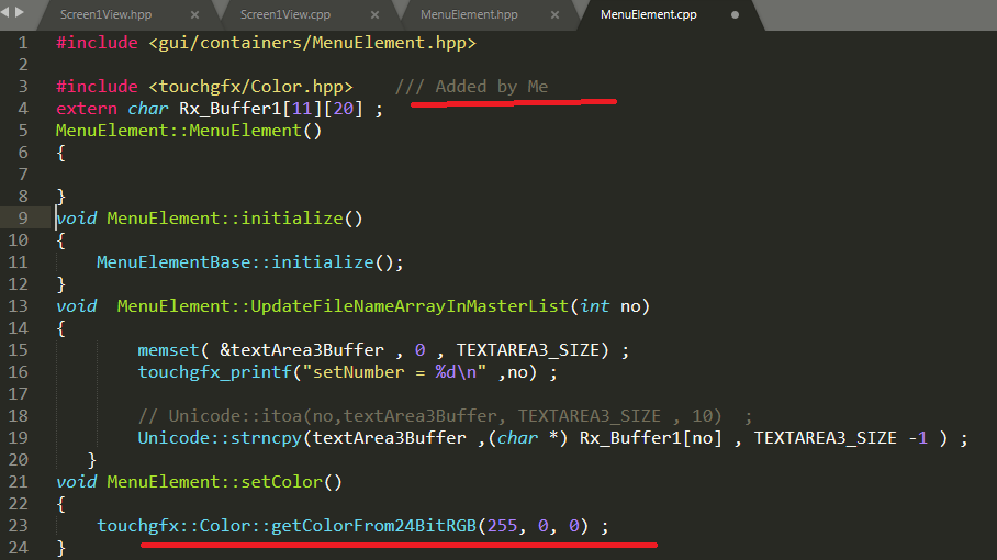

I am doing as below as your suggestion .. Able to send "Selected File name" of touchgfx_printf
But still not able to change the color of selected item ..
Please check and update ..
Thanks for your concern ..
Karan
Your function setColor won't do anything. If you look at the code for getColorFrom24BitRGB(), this only returns the color with the amount of Red, Green and Blue that you set as parameters.
To set the color you should call a function like:
box.setColor(touchgfx::Color::getColorFrom24BitRGB(255,0,0));
/Alexandre

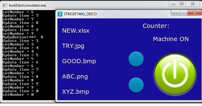

i want to implement same thing what you have done. But in my case, there is no touch screen available and I have a UP and DOWN keys for that functionalities.
If user pressed down key, then from list selection should also go down. In your case, if you select any item then it will be selected till you select another one.
If it is possible then can you please guide me for that? I think I can convert your up down keys functionality with external buttons (hardware keys).
For Scroll item in list you can do like this.You can replace Touch Buttons to Hardware Keys
void Screen1View::MyUpButton()
	touchgfx_printf("MyUpButton(**)  %d \r\n" , selectedMenuItem ) ;
	selectedMenuItem++;
	if(selectedMenuItem  > 10 )
		selectedMenuItem = 0 ;
	scrollList1.animateToItem(selectedMenuItem,1);
	scrollList1.invalidate();
