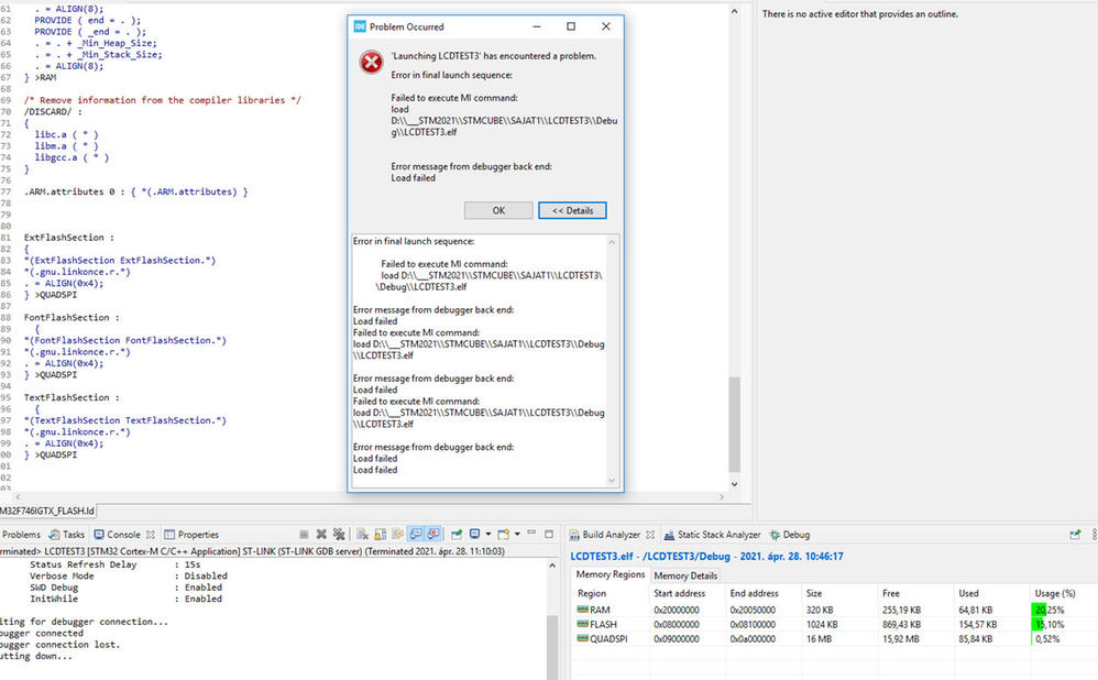

I'm using TouchGFX for a project, LCD and touch module are OK, but I have some problems with the QSPI driver (W25Q128 module).
I'm able to compile all the code and I see QSPI flash memory as used, but it gives me an error in "final launch sequence".
After including stm32746g_qspi.h (well, my board is an H743, but this file is modified by the vendor Waveshare: even if the name seems wrong, as you can see, it includes H7 headers):

 So I put some initialization lines in MX_QUADSPI_Init() function:
void MX_QUADSPI_Init(void)
  hqspi.Instance = QUADSPI;
  hqspi.Init.ClockPrescaler = 10;
  hqspi.Init.FifoThreshold = 4;
  hqspi.Init.SampleShifting = QSPI_SAMPLE_SHIFTING_HALFCYCLE;
  hqspi.Init.FlashSize = 23;
  hqspi.Init.ChipSelectHighTime = QSPI_CS_HIGH_TIME_2_CYCLE;
  hqspi.Init.ClockMode = QSPI_CLOCK_MODE_0;
  hqspi.Init.FlashID = QSPI_FLASH_ID_1;
  hqspi.Init.DualFlash = QSPI_DUALFLASH_DISABLE;
  if (HAL_QSPI_Init(&hqspi) != HAL_OK)
    Error_Handler();
  BSP_QSPI_Init();
  BSP_QSPI_MemoryMappedMode();
 HAL_NVIC_DisableIRQ(QUADSPI_IRQn);

Finally, I modified my linker file and after compiling (without error) I can see the ToughGFX ExtFlashSection loaded in QUAD SPI.
0693W000007C3MqQAK.pngThe problem is that the firmware isn't loaded on my board and I have this error:
0693W000007C3QOQA0.pngCan someone help me?
Thanks and Best Regards!

Dear @Community member​ !
Many thanks to reply me. I copy the stldr file, and use it. It seems to be someting is not good.
0693W00000AMk2RQAT.jpgWhere i search the problem?
Kind regards

Your external loader works with STM32 Cube Programmer. It is fine.
But i haven't to adapt in Cube IDE.
Which is the best setup, to debugger?
kind regards
Peter
I suspect it is in amongst the metadata of the settings/options. Probably in the debugger settings.
