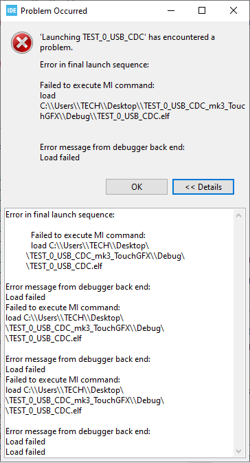

Hello!
I'm using TouchGFX for a project, LCD and touch module are OK, but I have some problems with the QSPI driver (W25Q128 module).
I'm able to compile all the code and I see QSPI flash memory as used, but it gives me an error in "final launch sequence".

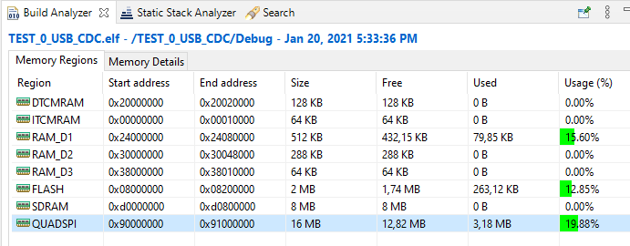

Finally, I modified my linker file and after compiling (without error) I can see the ToughGFX ExtFlashSection loaded in QUAD SPI.
The problem is that the firmware isn't loaded on my board and I have this error:
Can someone help me?
You've got to love the steaming heap that's been delivered here..
Yeah, so that's probably not related to your code, but rather the need for an external loader at the download/debug level that can handle your custom hardware. The processor doesn't have any internal way to deliver data to external memories (random devices, using random pins, etc, billions of possibilities)
Tools like STM32 Cube Programmer need a custom "External Loader", as small RAM based loader applet that configures the clocks, pins, peripherals and implements Erase, Write and Read functionality.
If you have an External Loader (.stldr) you need to tell the tools about it, where to find it, etc.
If you don't have one, you've got to write one. Or find one. I've posted ones for the W25Q128 in the past.
