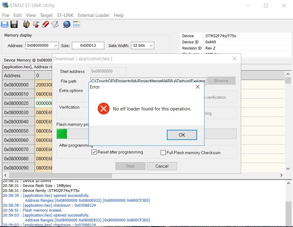

‎2019-06-06 1:14 PM
Thanks for the detailed answer.
But I did not understand why this error occurs.
I also tried to program using ST-LINK Utility and got an error:
The logical question is whether this will be fixed in the next update, because in version v1.1.0 it works fine?
‎2019-06-06 11:23 PM
Hi @Hosting​,
Maybe V1.0 supported a flashloader for the QSPI directly in the EWARM project. But this is definitely not something that we'll be doing going forward - It's too much work because we sometimes have to make them ourselves.
Using ST-Link, could you try the following?
1) Upgrade the firmware on the chip (ST-Link -> Firmware update)
2) Make sure you've specified the flashloader for the STM32F746G-DISCO under "External Loader"-> "Add External Loader". And find "N25Q128A_STM32F746G-DISCO"
/Martin
‎2019-06-07 2:43 AM
2) Make sure you've specified the flashloader for the STM32F746G-DISCO under "External Loader"-> "Add External Loader". And find "N25Q128A_STM32F746G-DISCO" - it really worked.
But this way was strange, and before that it is necessary to guess. Doing debugging in search of an error for me it was not obvious that the code lacks a bootloader in an external flash drive.
Thank you, it was a good experience.:smiling_face_with_smiling_eyes: ;)
