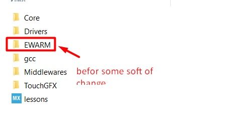

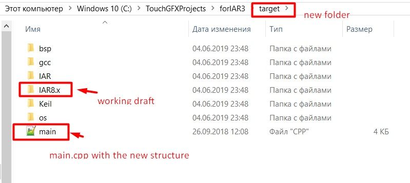

I did not understand what has changed, maybe the guys from ST updated something, but the folder structure changed when generating code in the TouchGFX designer. The main.cpp file has also changed. Now the debugger successfully starts and works. I apply screenshots of the project folder structure generated before and after some changes.0690X000008iDcTQAU.jpg

Looks like you're using the latest version of the Application template for STM32F746G-DISCO (v2.0+) which is CubeMX enabled (has an .ioc file). The previous one (v1.0.0) did not. In any case, the folder structure between those versions of the Application template has changed. Does that make sense to you?
Verified. Indeed, STM32F746G-DISCO (v2.0+) has error while debugging, and V 1.1.0 version works good.
And how to use version 2.0 correctly? Or is it Bug?
