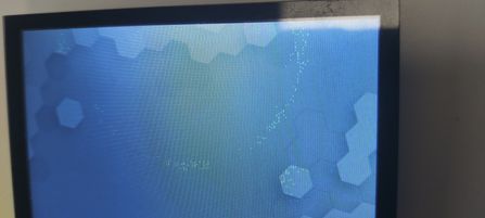

I have made a custom project with STM32H735IGT. I use Touchgfx.
I am using external flash and external RAM. The problem is when I place the framebuffer in external RAM. Some green pixels appear as in image 1. When I place the framebuffer in internal RAM, the image is painted well.
I am using IS66WVH16M8DBLL-100B1LI RAM. I attached hardware configuration, the RAM is OCTOSPI2.
Where is the problem?

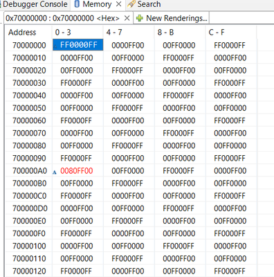

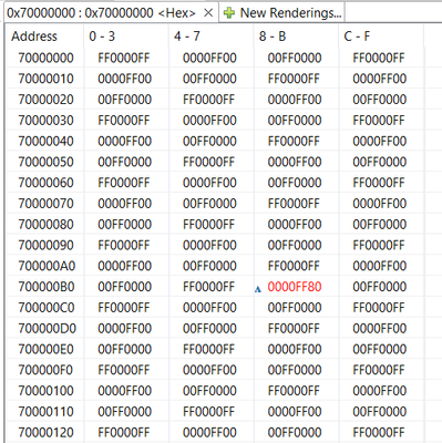

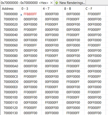

I have done more tests.
I have placed the screen all Blue. In debugging I have been looking at the external RAM, and I could see the following errors. And they repeat.
Any idea why that could be?

‎2023-09-25 8:47 AM
I think its jitter, this is serial , this can be only this, because 8 value is 1000b and this is the first bit after 0xF (1111b). Check the clock line and try different serial resistors value. In first, put 0R and try.
‎2023-09-25 9:02 AM
I can write without problem 0x70000000
I have tried with resistance of 0, and resistance of 33
