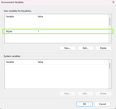

‎2024-12-12 2:13 AM
Hi @GMeur ,
You are welcome, I just add it to all the env var, but maybe if you just created it restart VS,
And in vcxproject file :
I hope it helps,
