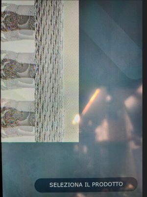

My problems with Portrait orientation don't end.
I have a very large project where changing the architecture and function calls costs much more than changing a single function.
My problem is how?
The function is readBMP24File.
In my project it is loaded from several places and many different screens.
In the original project it works very well, many images are called or even of different sizes from an MMC with fatfs.
Has anyone solved the problem of changing orientation without having to change the position and orientation of the images?
I'm starting to have serious doubts that the touchgfx gui really helps in the work I do.
If anyone can help me in solving the problem with a new or different algorithm I would be grateful.

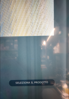

Thank you for the information. One important thing, are you allways using and facing issues with 'big' pictures in your project. I mean pictures which are in some direction bigger than display. What if you make for example 200x400 pixel picture. Is it also disturbed in portrait mode ?
Br jtp
480x272 picture:
this is the output:
Did you change the width and height vice versa which were exracted by getBMP24dimensions, like earlier with chip bag image ?
Br jtp
thanks for your attention...
but no luck...

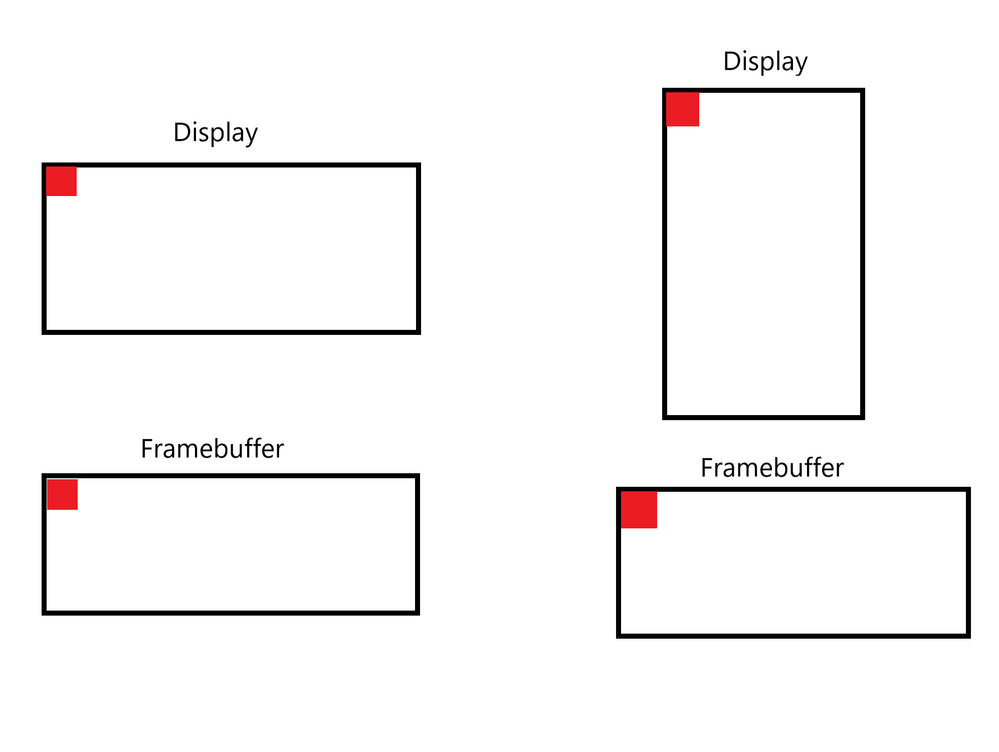

I can see that in the BMPFileLoader, the loop that writes data into the framebuffer should be changed to support portrait mode. Keep in mind that when you want to display using portrait mode, the framebuffer still looks like landscape but the coordination is different now. In other words, in landscape, the top left corner represents the first element of framebuffer array. It is the same case in the portrait mode however, now if we want to move through the framebuffer elements, we have to switch the values of x and y, and this is not reflected inside the loop (line 24-76 of the code you shared).
(I added a simple image to demonstrate what I mean)
Relation between framebuffer and the displayRelation between framebuffer and the display
A similar implementation is available in the QR Code widget that is shared on the forum. I suggest you taking a look at that, and apply some changes to the BMPFileLoader.

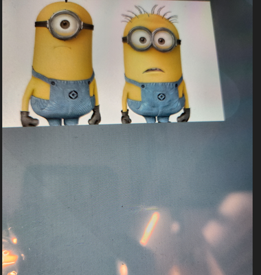

Hello
Please test the attached version. It should keep now the image same position in landscape and portrait mode (eg. rotates the image). was it what you needed ?

IT WORKS!
Thanks JTP, really thanks, everything works and does what it's supposed to.
