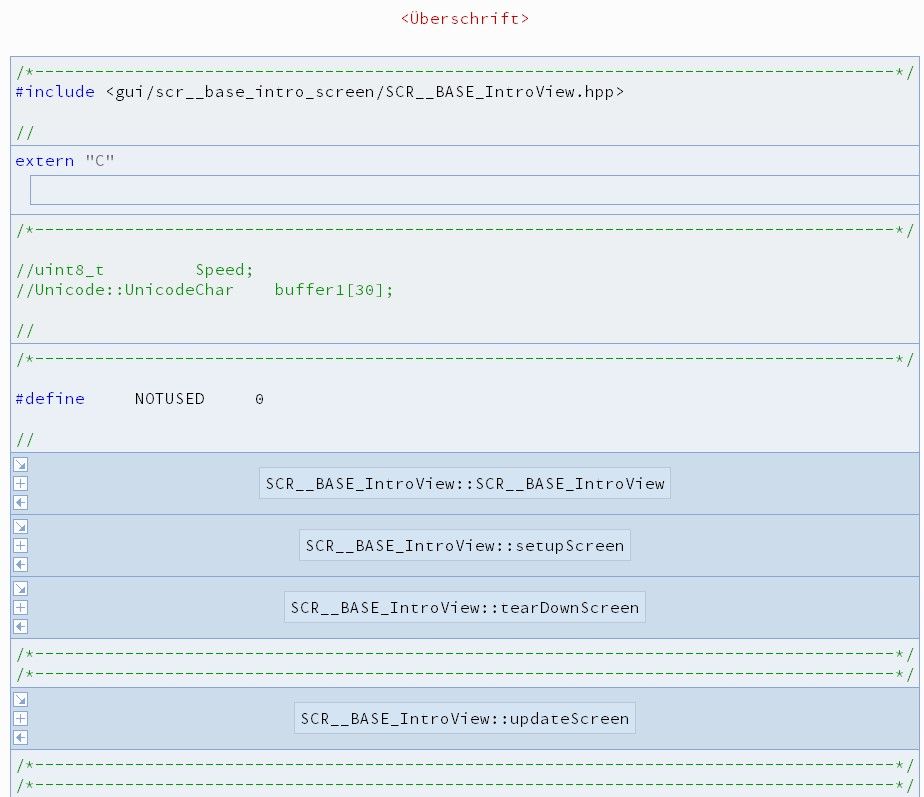

Here is a very simple example of what I would like to have:

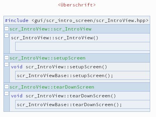

This is how the code is currently generated:
#include <gui/scr_intro_screen/scr_IntroView.hpp>
scr_IntroView::scr_IntroView()
void scr_IntroView::setupScreen()
    scr_IntroViewBase::setupScreen();
void scr_IntroView::tearDownScreen()
    scr_IntroViewBase::tearDownScreen();
This is how I would like the code to be generated:
#include <gui/scr__base_intro_screen/SCR__BASE_IntroView.hpp>
extern "C"
//uint8_t         Speed;
//Unicode::UnicodeChar    buffer1[30];
#define     NOTUSED     0
SCR__BASE_IntroView::SCR__BASE_IntroView()
    //char    mcmd[10];
    SCR__BASE_IntroView::updateScreen();
void SCR__BASE_IntroView::setupScreen()
    SCR__BASE_IntroViewBase::setupScreen();
void SCR__BASE_IntroView::tearDownScreen()
    SCR__BASE_IntroViewBase::tearDownScreen();
void    SCR__BASE_IntroView::updateScreen( void )
    //char    mbuf[30];
    //char    dummy = 0;  /* Brechpunkt */
    /* Unicode::    snprintf(UnicodeChar dst, uint16_t dstSize, const char format, ... )    */
    //Unicode::snprintf( flexMethodeBuffer, sizeof(flexMethodeBuffer), "%02i", gt.AktMethode );
    //dummy++;    /* Brechpunkt */
    //Unicode::snprintf(textMethodeBuffer, TEXTMETHODE_SIZE, "%02i", gt.AktMethode.ActMethodenNummer );
    //textMethode.setWildcard(textMethodeBuffer);
    //textMethode.invalidate();
    // gt.AktMethode.steps[ gt.AktMethode.ActStep
    //AktGT.IstStepDaten.
void    SCR__BASE_IntroView::RcvdCommand(long m_screen, int m_token,  char *m_mess, long m_val1, long m_val2 )
    /*  Aus _Screens.h die defines fuer die Screen-ID und die Befehle (token) die           */
    /*  dieser Screeen kennt.                                                               */
    //#define     SCR_ALLE                         		1000
    //#define     TOKEN_SCR__ALLE_ACTTIME        		1000
    //#define     SCR__START                        	2000
    //#define     TOKEN_SCR__START_RUNSTART          	1000
    //static  int dummy = 0;
    switch ( m_screen )
    case SCR__ALLE :
        switch ( m_token )
        case TOKEN_UPDATE_SCREEN :
            break;
        default:
            break;
        break;
    case SCR__BASE_Intro :
        switch ( m_token )
            break;
        default:
            break;
        break;
    default:
        break;

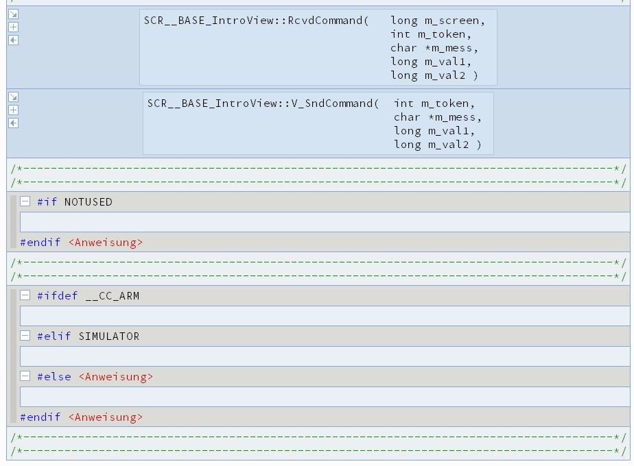

void    SCR__BASE_IntroView::V_SndCommand( int m_token,  char *m_mess, long m_val1, long m_val2 )
    //char    mcmd[30];         /*                                                              */
    //https://www.youtube.com/watch?v=SYdyJBehcYY
    presenter->P_SndCommand( m_token, m_mess, 0, 0 );
#if NOTUSED
#endif
#ifdef __CC_ARM
#elif SIMULATOR
#else
#endif
And yes, the V_SndCommand() function belong in “FrontApplication.cpp”.
That comes next.
Oh yes, and this is what it looks like in my favorite editor:
Generated:
wish:
(I also like to call myself a “formatting fetishist”)
