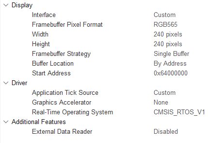

I made the project for a custom SPI display with configuration like screenshot below:

And in TouchGFXHAL.cpp:
extern "C" void TouchGFX_TickHandler();
void TouchGFX_TickHandler() {
  OSWrappers::signalVSync();
The function TouchGFX_TickHandler() called one time and hangs on OSWrappers::signalVSync(). As a result (?) functions void TouchGFXHAL::flushFrameBuffer(const touchgfx::Rect& rect) and Screen1View::setupScreen() are never called.
I'm using the latest software (TouchGFX 4.16.1, latest HAL/CMSIS etc).
Is this a bug or am I missing an important detail?
