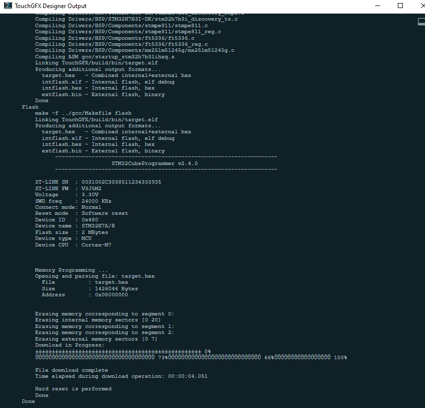

has anyone run an UI-Template with the STM32H7B3I-DK Board?
I get only a black screen....
All the time. What happens when you just use a blank template and create a simple application?
/Martin
I open GFX Designer, select AT for STM32H7B3I DK and select the blank UI Template.
Create the project and add an Image and a simple Button.
Press "Run Target" and the after building and flashing nothing happens....
And flashing is succesful?
