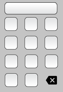

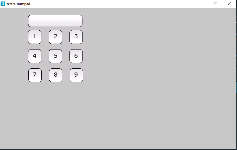

oh i wrote a code for numpad with edit touchgfx sample every thing is good but i don't know how can i change keyboard size... my design is:
but in the simulator
how can i resolve this problem?
‎2020-08-23 4:26 AM
oh i forget to save that the problem solved with:
keyboard.setPosition(80, 16, 220, 340);:grinning_face_with_sweat: :grinning_face_with_sweat:
