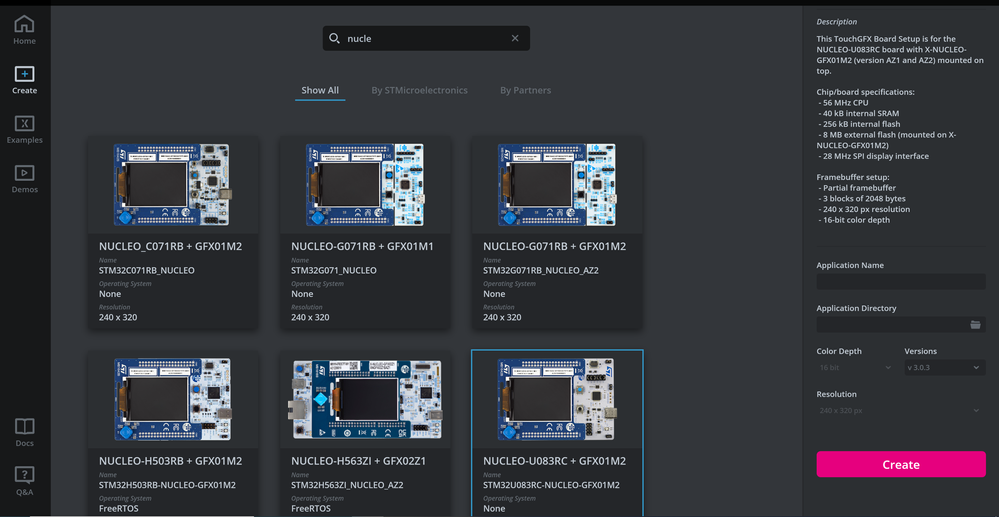

Is it possible to integrate NUCLEO-H7A3ZI-Q + X-NUCLEO-GFX02Z1 into TouchGFXDesigner?
Or is it possible to change MCU in NUCLEO-H563ZI board by H7A3ZI into TouchGFXDesigner?
Hello @PhilZalkin ,
Currently, there is no plan to add NUCLEO-H7A3ZI to the TouchGFX Designer. And, you cannot simply change the MCUs in one project to another one since there are numerous configurations that must be handled for each case.

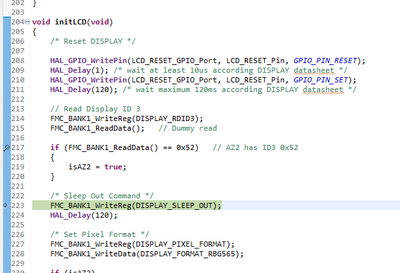

In the initLCD function,
The FMC_BANK1_ReadData() function always returns 0.
isAZ2 always false
attached my configuration configuration file.
I must have forgotten something...
Thanks

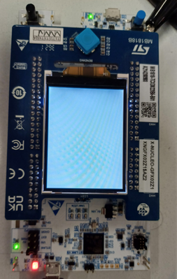

My screen is :
Hello @PhilZalkin ,
Unfortunately, I don't have access to the hardware to test it manually, however, your configuration looks fine (the pinouts for FMC correspond to the MCU schematics and the Display schematics
Maybe it is better to just focus on showing simple data on the screen by following the guide available here, and afterward, combining it with TouchGFX.
