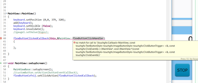

2024-07-31 12:17 PM
@JTP1  yours advice with callback is good and I can compile project.
Outputs are turn on/turn off but they are switched all the time when I hold the flexButton - the same effect I had at the beginings, when I wrote here.
Here a code od MainView.hpp:

MainView::MainView():
flexButtonClickedCallback(this,&MainView::flexButtonClickHandler)
  keyboard.setPosition (0,0, 379, 320);
  add(keyboard);
  keyboard.setVisible (false);
  keyboard.invalidate(); //gaugel.setValue(bigos),
void MainView::setupScreen()
    MainViewBase::setupScreen();
    //customButton.setAction(buttonEventCallback);
    flexButtonCofnij.setClickAction(flexButtonClickedCallback);

void MainView::flexButtonClickHandler(const touchgfx::TextButtonStyle< touchgfx::ImageButtonStyle< touchgfx::ClickButtonTrigger >  > & b,const ClickEvent& e)
	if(&b==&flexButtonCofnij) // button1 -> your button name
		if (e.getType() == ClickEvent::PRESSED)
			//touchgfx_printf("Button is pressed..\n");
			presenter->setPin();
		else if (e.getType() == ClickEvent::RELEASED)
			//touchgfx_printf("Button is released..\n");
			presenter->resetPin();
Here a code Model.cpp:

Can you help me to find a faulty in my code?
2024-07-31 12:28 PM
Hello. In this case i would check the touch panel handling/reading, is the sampleTouch-function getting steady and consistant coordinates every time it is called.
Br JTP
