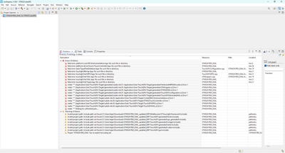

Hi Johan and ST Micro Technical Support Team,
We previously shared a snapshot of the hard fault in our earlier communication. As we are new to TouchGFX and its environment, we kindly request that you provide the exact steps for commenting out the section in TouchGFX/target/STM32TouchController.cpp.
Additionally, please share detailed instructions on how to update to the latest version of the BSP. Clear guidance will help us avoid further delays.
We urgently request your assistance in resolving this issue, as we have already been waiting a long time for support from the technical team. After flashing through TouchGFX, the program counter remains stuck at a hard fault. We believe it is important to investigate the root cause of this issue. Kindly validate the problem on your setup using the same revision number as ours and share the results.
We have already invested in purchasing the evaluation board and spent significant time debugging issues on the new board. As customers, we expect STMicroelectronics to deliver fully supported and tested boards. It should not be the customer’s responsibility to debug problems on a brand-new board.
If the issue is not resolved within the next two weeks, we kindly request that STMicroelectronics replace the current board with a new, fully functional one.
We look forward to your prompt support and resolution.
Best regards,
Tejas Patel
JohanAstrup
Hello again.
Sorry - I missed the screenshot you shared earlier. However, it clearly shows that the system hardfaults because of the touch controller.
Therefore, I am almost certain that this is not an issue with the hardware you received, but rather an issue solely with the TBS available in TouchGFX Designer.
As mentioned previously, I do not currently have the hardware revision you are using, so I cannot test and validate a fix myself. However, I have tried updating the official TBS to the latest version of the BSP. The project is attached. Please validate whether this resolves your issue. If you confirm that it does, I will upload a new version of the TBS with this fix.
Best regards,
Johan
Hi Johan,
I have imported your project in My Cube IDE setup. But while build it giving me errors.
Regards,
Tejas Patel
JohanAstrup
Thank you for trying it out!
It looks like you may not have generated code in TouchGFX Designer first. Could you please try that? If you already have, please generate the code again.
When building the project, the process should be:
1. Open the .touchgfx file in TouchGFX Designer.
2. Create a GUI.
3. Generate code in TouchGFX Designer.
4. Open the project in STM32CubeIDE.
5. Build the project in STM32CubeIDE.
However, while validating the steps above, I realized that I forgot to update the STM32CubeIDE project file with the GT911 references in the project I previously shared. Because of that, that project also requires generating code in STM32CubeMX. I have attached a new project that does not have this issue.
Best regards,
Johan

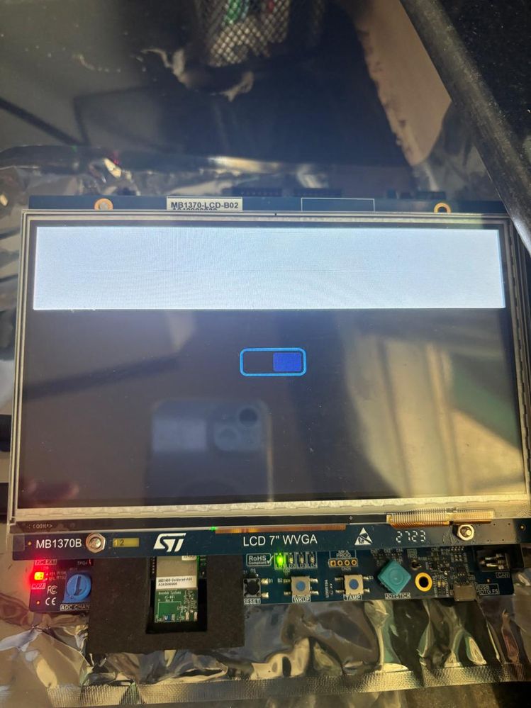

tejas210
Hi John,
# BSP2 package i have opened, build and flash from touch GFX.  GUI is coming on LCD screen and i have tested on touch button it was working.
# If i open it on CUBE IDE and then build and flash it also working.
# I have attached sanpshot of GUI created. WhatsApp Image 2026-05-02 at 3.28.59 PM.jpeg
# Now how to make it work in my own project.  Please guide for the same.
