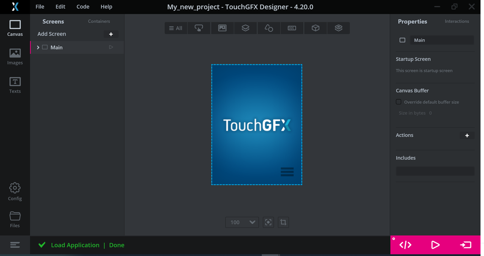

sorry for replying late, as was busy on other work, thanks for your inputs. i returned back to touch Gfx designer and installed the software once again,
- this time i was able to create basic UI applications in touch GFX designer and then open the code in STM32 cube IDE, build it and run the elf file on the STM32F429I- DISC1 target board. it worked we i got proper navigation of screen using the buttons.

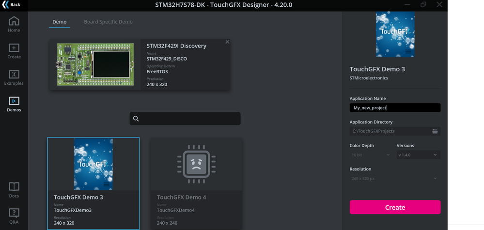

- i am attaching some screen images
- i am using Windows 10 and no internet connection issues.

My apologies, I've tried my test with a STM32F469-Disco and not a STM32F429-Disco as you needed. Sorry about that.
I've tested now with the correct board and yes as you mentioned, using examples provided example with this board is not possible. The reason is that all UI Templates are running with a bigger resolution than the one supported by the STM32F429-Disco board (240*320). So unfortunately you can't use this example with this board.
BUT, you should be able to use the "TouchGFX demo 3" at least since the resolution fits perfectly.
Can you reproduce your issue and then send me your log file (C:\Users\YOUR_USER_NAME\AppData\Roaming\TouchGFX-4.20.0\TouchGFXDesigner.log), I'll try to investigate on that.

thanks for your reply, when i go to "Touch GFX Demo 3" and click on the Create icon, the progress bar proceeds upto 33 % and then i get the message of " Download of Touch GFX Demo 3 failed"
This type of problem i had faced earlier ( please refer the first post) where i was not able to download the Dice, please suggest some solution to overcome this issue,
my main intention is to get some hands on practice on this hardware and run to basic examples to get understanding of the environment ,so as to use it in my project.

6) i was able to create a simple application in touch GFX designer and test it with simulation
