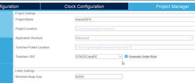

You should not "generate code under root" :

  3. "Generate under root": Unfortunately, since I’ve already created this project, I cannot revert the "generate under root" setting through the .ioc file. I’d need to start a new project from scratch to address this.
