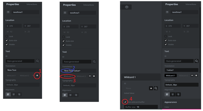

Hi Tmehok
Have you configurate wildcard buffer properly to your text area ?
1. First add one wildcard buffer
2. Then you can remove 'New Text' and leave just <value> to translation (this value means the wildcard content). Otherwise you will allways get some constant text before your wildcard content. Sometimes this can be useful, but mostly it isn't.
3. Then open wildcard 1- submenu
4. Check 'Use wildcard buffer' option.
Then you can also adjust size of your buffer and put some initial value to the buffer, if needed.
After regerate the code, buffer and size definition is generated to view.hpp, at least I've never had any problems creating it.

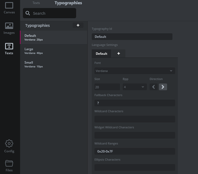

Please note also that you must list all possible characters to the Texts - Typographies page:
For example this range 0x20-0x7F covers numbers and letters and other basic characters. It you try to print character out of defined range, fallback characters (as default it is '?') is printed instead.
Here you find more information about defining the wildcard characters:

tmehok
I do not know if it is appropriate to say on this forum but I could kiss you. I put extra hours into work to get this working and I FORGOT TO CHECK USE THE BUFFER. It did not generate everything until I clicked that. You made this engineer very happy today. Thank you very much.
