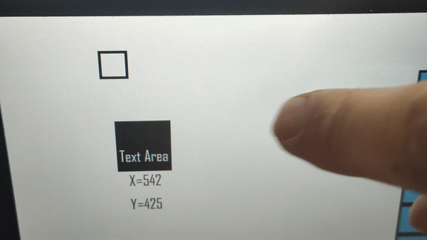

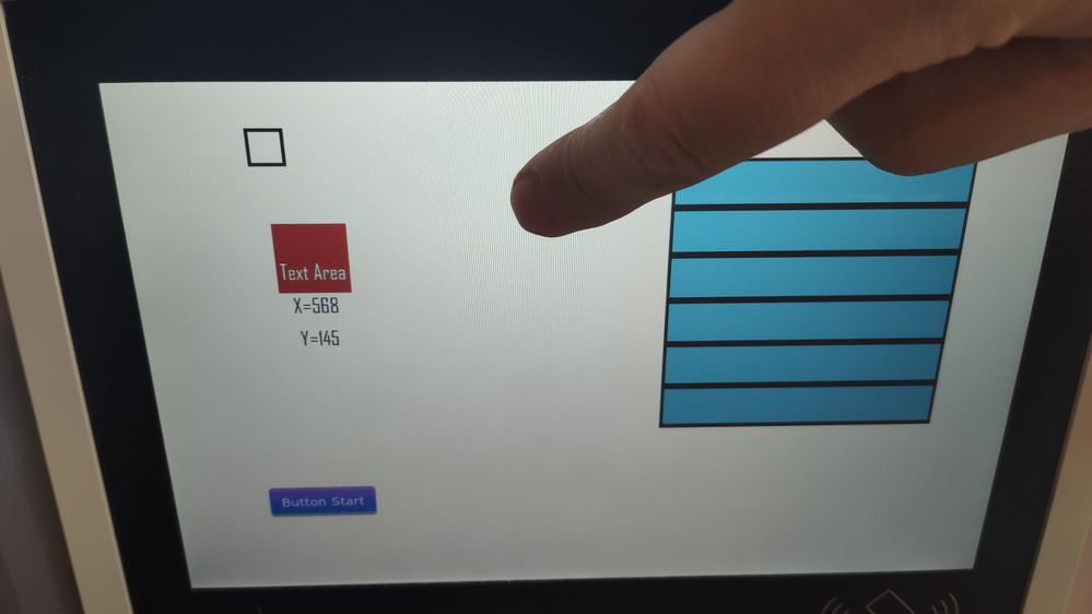

Variable touchDataReady sets true in I2C Interrupt,
when touch-panel data occured from I2C bus and translate to display-coords 1280x800
X=568
Y=145
is the real coords of my finger.
This coords Im passed via handleTickEvent.
They smoothly changed follows up my finger.
TouchGfx not take this coords from internal mechanics.

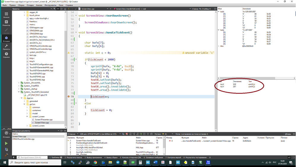

ANapa
ANapa

void Screen1View::handleTickEvent()
    char bufx[7];
    char bufy[6];
    static int c = 0;
    if(tickCount < 2000)
        sprintf(bufx, "X=%d", tscX);
        sprintf(bufy, "Y=%d", tscY);
        bufx[6] = 0;
        bufy[5] = 0;
        textX.setText(bufx);
        textY.setText(bufy);
        textX.area().invalidate();
        textY.area().invalidate();
        tickCount++;
    else
        tickCount = 0;
I can transfer all coordinates to handleTickEvent manually.
