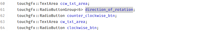

I notice that all of the radio buttons I have impleneted thus far belong to a single Radio Button Group in TouchGFX Designer (identified in the Properties Menu under Group). I don't see a way of adding multiple entries into this property field in order to handle the values of another pair. In other words the name given to the first array of buttons in the Radio Button Group manages all radio buttons added thereafter.
This is not the behaviour I am looking for as, interacting with one pair of buttons on one screen - for example - an on/off pair, directly affects the values set of another pair on another screen.
Currently, my project has 3 pairs of radio buttons grouped in an array of 6. Is it possible to break these down into 3 separate pairs of 2 in user code?

I can't believe I didn't try this before posting. Doh! Just over type the existing Radio Button Group with another then assign the relevant buttons to the new group! Simples!
