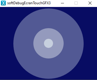

I'm trying to do an animation with 3 circle whose radius are increasing. The problem is that when the 3rd circles animation (ie its radius is increasing) starts, the frame rate drops.
Here is the sample of the code doing this animation :

and what we should see :

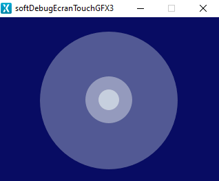

(a bit later)
I think the frame rate drops because I invalidate whole circles and it is too much for the MCU but I didn't find another way to just update the radius.
