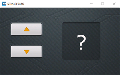

Using TOUCHGFX Rev 4.24.2
And following https://support.touchgfx.com/academy/tutorials/tutorial-02
TextArea widget fail to show valid value.
void MainView::buttonUpClicked()
    touchgfx_printf("buttonUpClicked\n");
    counter++;
    Unicode::snprintf(textCounterBuffer, TEXTCOUNTER_SIZE, "%d", counter);
    // Invalidate text area, which will result in it being redrawn in next tick.
    textCounter.invalidate();
What am I missing?

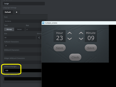

Daniel_Marosi

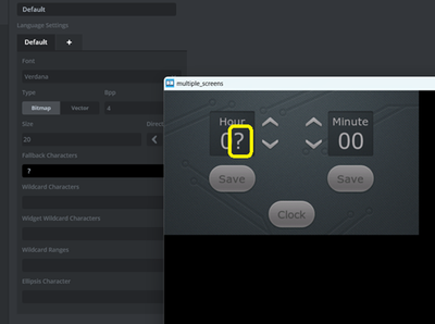

Problem:
Display ? in Text Area
Solution:
Add wildcard Range 0-9 in <Texts><Typograpies>
1 REPLY 1
Daniel_Marosi
Problem:
Solution:
