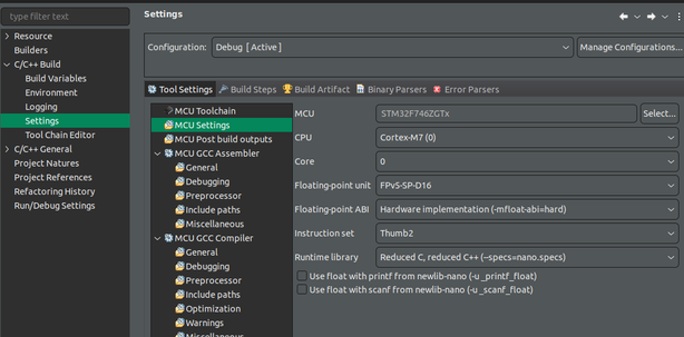

2- Based on the following settings, is my bitmap_database supposed to be all zeros instead of addresses?

The problem was that due to floating point option not being enabled, somewhere in the matrix code a double precision, was being written to a signle precision S register.
I found out the example project I was applying touch gfx to, had the FPU disabled. "Project properties/C/C++ build/Settings/Tool Settings/ MCU Settings/ Floating-point unit" was set to none. I assigned it to FPv5-SP-D16. I also assigned floating point ABI to Hardware implementation. This option needs to match the linker library being used. It determines if software takes care of floating point conversion or the hardware (or a mix).
Cube IDE was no help in debugging, so I reached out to a colleague and they thought me how to use disassembly through debugger console and pin point exactly which assembly command is causing a hard fault. This was very interesting to figure out. I basically used disaassemble command and disassemble *<memory address> to figure out what is happening inside the function. Thank you @GaetanGodart  for pointing that issue out, I performed a workaround and manually added the following script to a .cpp file and got past vector rendering issues.

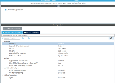

GaetanGodart
Hello @bornamm and welcome to the community!
In the TouchGFX SVG article it is mentioned that "Vector Rendering" have to be enabled to allow the use of SVG.
In your picture, this is the second line under "Additional Features" and it is currently set to "Disabled".
Enabling it could resolve your problem.
