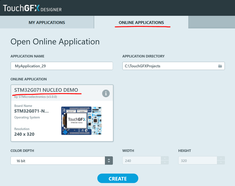

The next step is to add the ENTER key to the keyboard to take what has been entered.
I imagine a scenario in which, again by joystick, I select a field (TextArea widget for example). When the joystick is pressed ('5'), the keyboard is shown, the user enters the text and when the ENTER key is selected, the keyboard disappears and the entered text is written in the selected field.
How to implement? Tips?
ALomb.1
I @Romain DIELEMAN​,
about my last questions searching in the community I found this post that, I think, it is a common problem in all those scenarios where touch is not present!
Is it possible to have an example from which to start ?
/Antonello
I am not sure I fully get it, what you are looking for is a project where the buttons are used with a TouchGFX project ? If yes, you can have a look at the "STM32G071 nucleo demo" found in TouchGFX Designer when creating a project, in the "Online Applications" section.
0693W000007ZLQ3QAO.png/Romain
