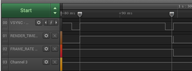

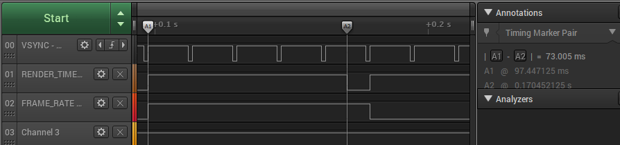

The rendering time for a static frame with 4 buttons without images is about 15ms. With the moving images like above the rendering time is >70ms. The 30ms from the first post where with some optimization (only one wave,...)
I've made a more detailed analysis (see attached excel file). There are 5 "delays" with more than 7ms where the TouchGFX Library is doing something but I don't know what. Do you have any idea what happens there?

Renderingtime static screen:
Renderingtime moving images:

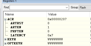

Is your QSPI set up properly? Reading from QSPI will also impact render time, regardless of ChromART.
Marco.R
Senior
Yes, QSPI is set up in memorymode and runs at 108MHz. (measured on hardware)
What I'm wondering is whether the 15ms for a static frame is also much too long, although there is no need to access the QSPI Flash.
What I noticed is that setupDataCopy is never called. Shouldn't this method be called if a data should be transfered from Flash?
