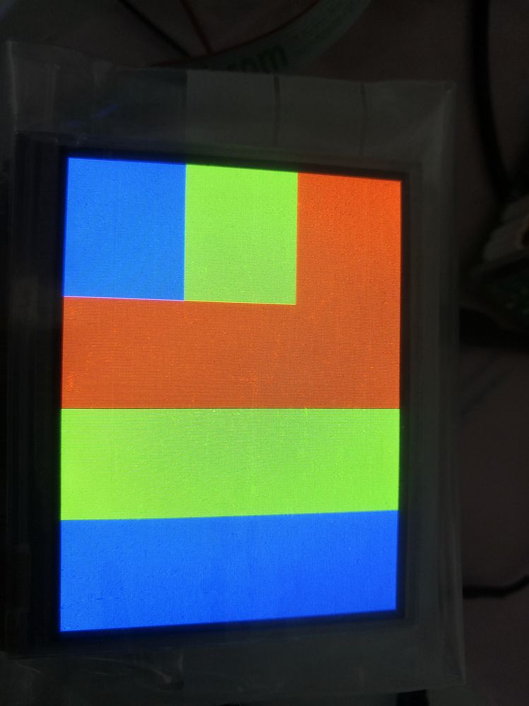

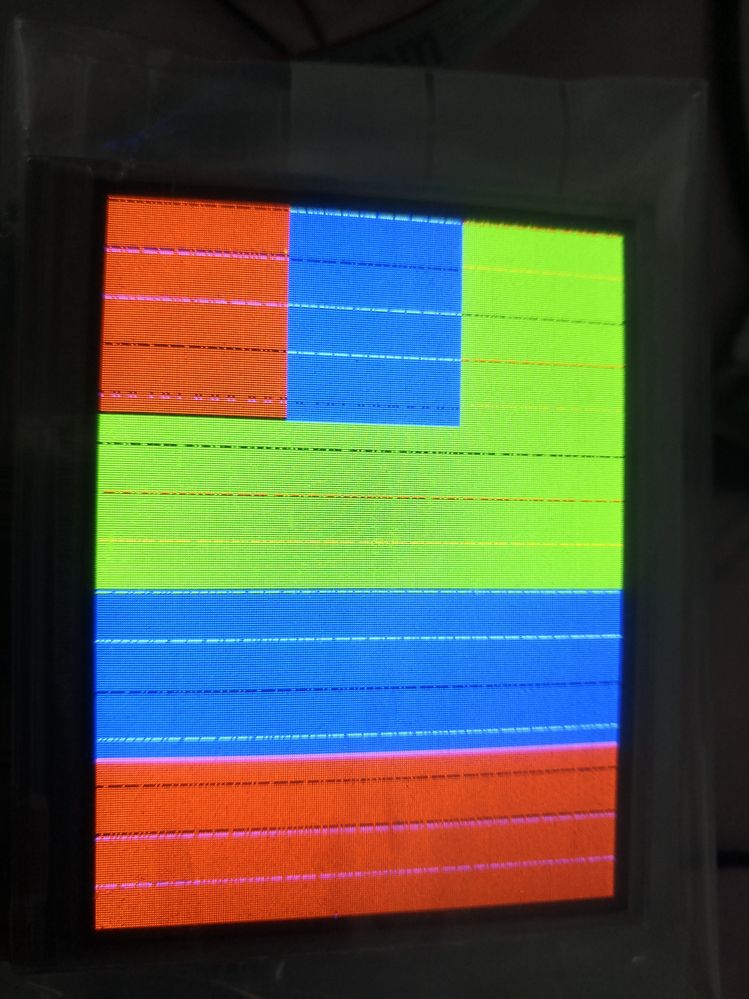

I am integrating TouchGFX on custom board (STM32F767II) with external SDRAM (AS4C16M16SA).
The issue I am trying to solve is the color swapping with external SDRAM. When the internal RAM is used the colors are displayed correct.
I have attached two pictures :
  • external SDRAM : has the colors swapped with some lines
  • internal RAM : has the correct colors and is clear (-> RGB from right to left and from top to bottom)

That looks strange. Can you verify that the contents of the framebuffer when in internal RAM is the same as when it is in external sdram?
Thanks!

I've found out that the FMC Clock and ClockEnable is not working. The layout of my PCB looks correct. Did I forget to set something in CubeMX?

I have an update.
The clock is now working.
But I am still trying to get the ram (FMC) working correctly.
Regards
Dejan
Hi @Martin KJELDSEN (ST Employee)​
I've found out what is wrong with my setup.
When I'm using the FMC_SDRAM template of the stm32f746 discovery board on my custom board with a STM32F767II and an external SDRAM AS4C16M16SA then the nibbles are swapped. (STM32Cube\Repository\STM32Cube_FW_F7_V1.15.0\Projects\STM32746G-Discovery\Examples\FMC\FMC_SDRAM)
For example:
I'm writing 0xA244250F to the SDRAM
When I'm reading it back, I get 0x250FA244
Is there a possibility to set this in the CubeMX FMC settings?
Regards
Dejan
if you setting
CASLatency = FMC_SDRAM_CAS_LATENCY_2;
You need to change
SDRAM_MODEREG_CAS_LATENCY_3
to
SDRAM_MODEREG_CAS_LATENCY_2
in: /* Step 5: Program the external memory mode register */
