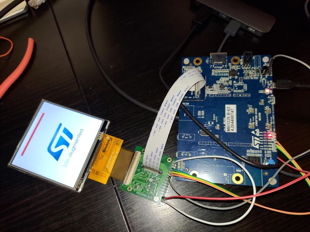

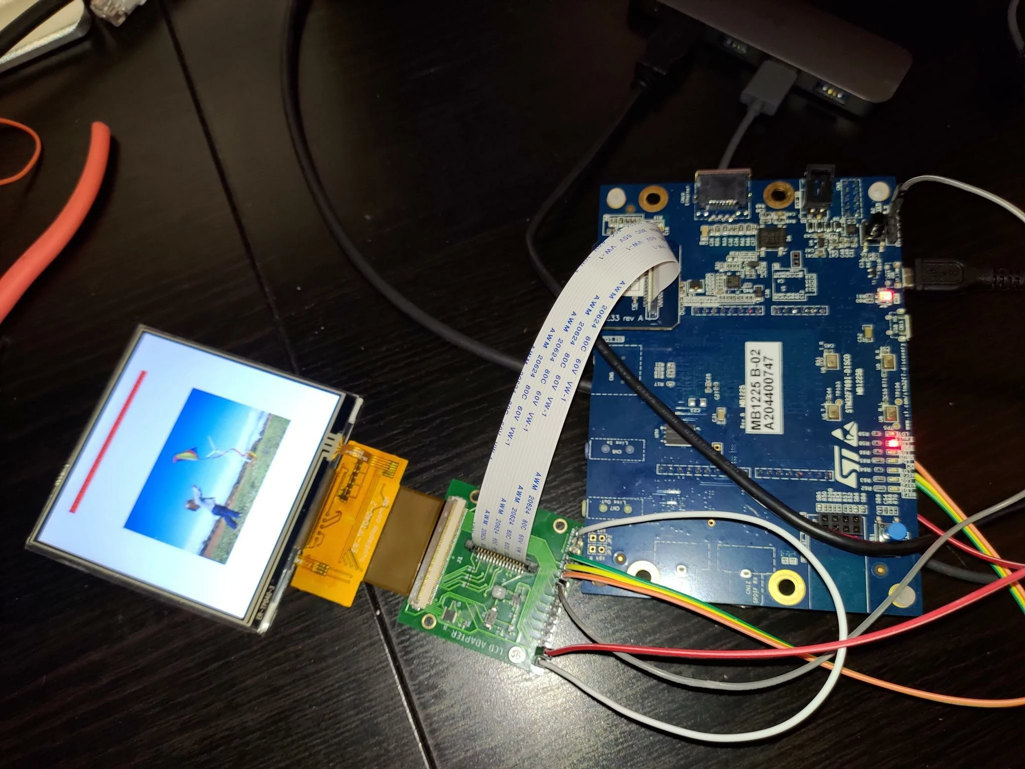

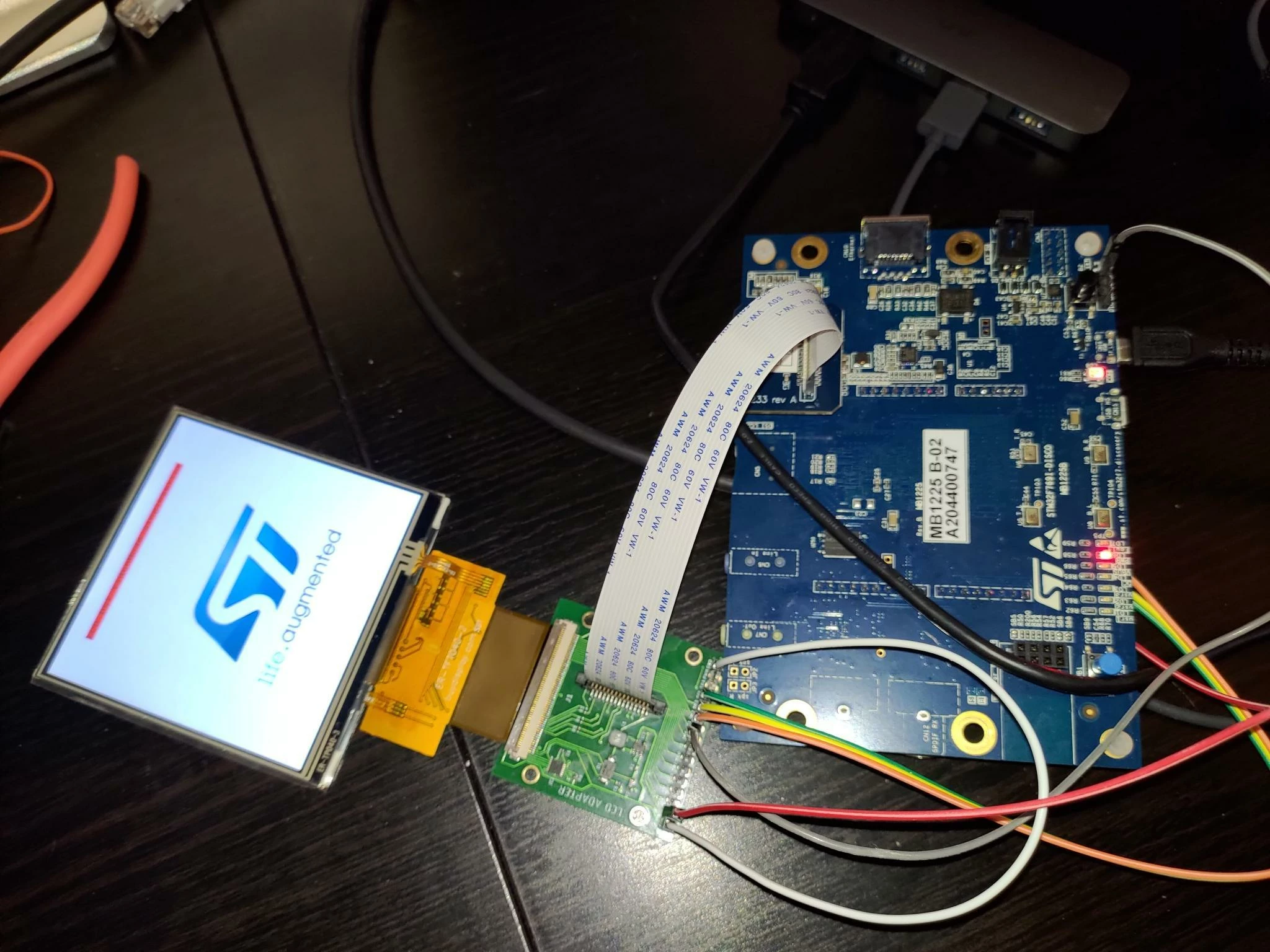

I'm using DSI in video mode +LTDC in Stm32f769IITX to interface with LCD driver "ST7701"
and i am facing problems to display an image even i followed the manufacturer initialization sequence. so, i contacted with the the "ST7701" supplier which said that "STM mcu is not compatible with lcd driver "ST7701" ,"NT35510MH" as well.
22 replies
JMD
July 31, 2021
Hello everyone,
By using LCD_DSI_VideoMode_SingleBuffer of STM32F769I_DISCOVERY with a MIPI adapter and with a homemade adapter and by changing INIT LCD by the one provided by ari_v2 I am able to use my 480*480 LCD screen with ST7701 controller. I don't have any issue when I blink image link in the demo. I will try soon with TouchGFX.
So ST7701 seems to be compatible with STM32F769I

JMD
August 1, 2021
The artefacts I see are most noticed upon changing between screens with graphics.
For the moment I can't see any artefacts when I switch a picture in the middle of the screen in a loop like in the example so I hope I will obtain the same with TouchGfx.
I don't change anything else except initLcd and replace 480*800 by 480*480 it was unbelievable, I use all default setting, same frequency of the DSI discovery board example and video settings.

Please find attached a full project working on the discovery board for reference.
I will try TouchGfx in next days, I will keep you informed.
Best regards,
Julien.

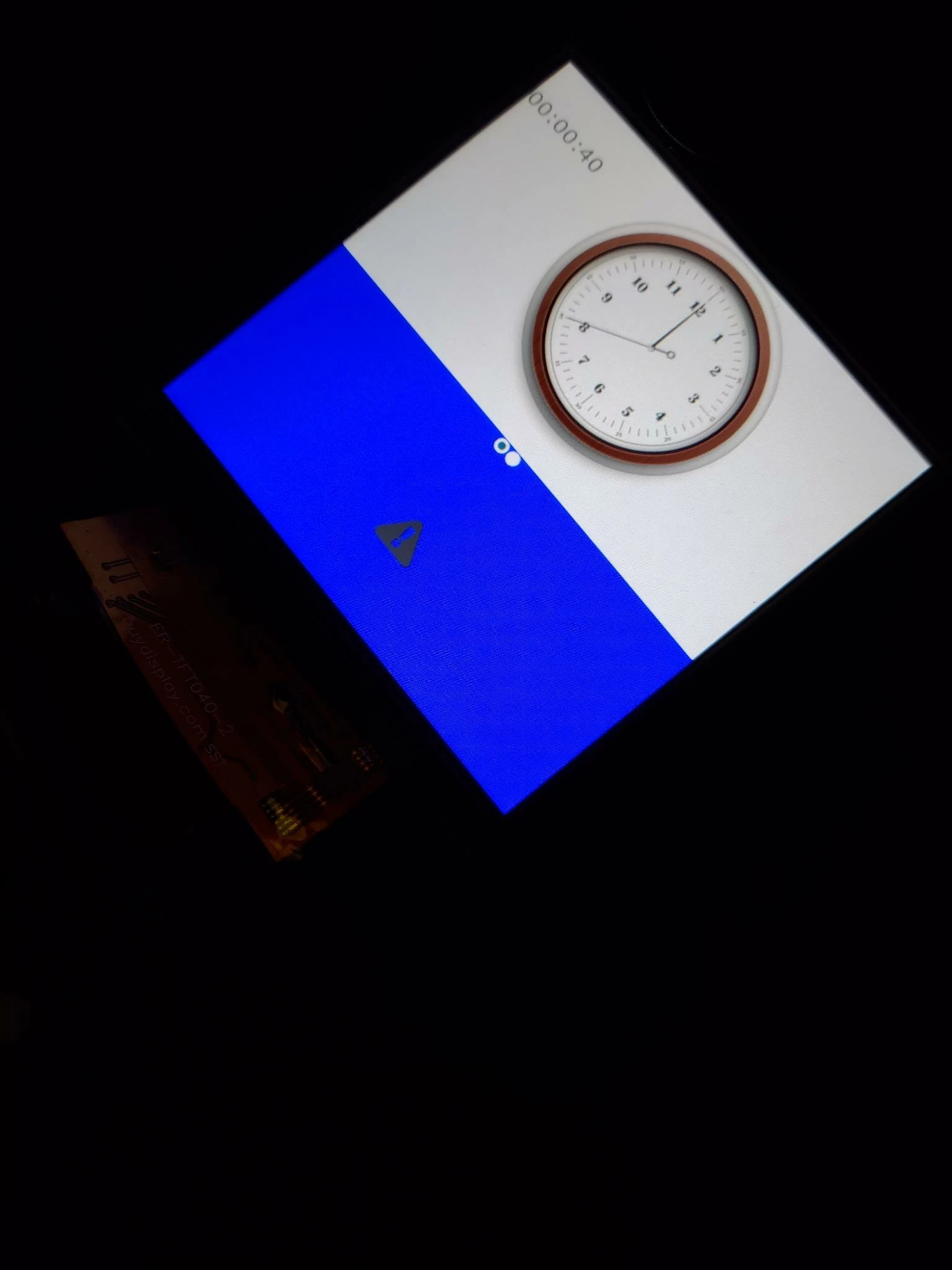

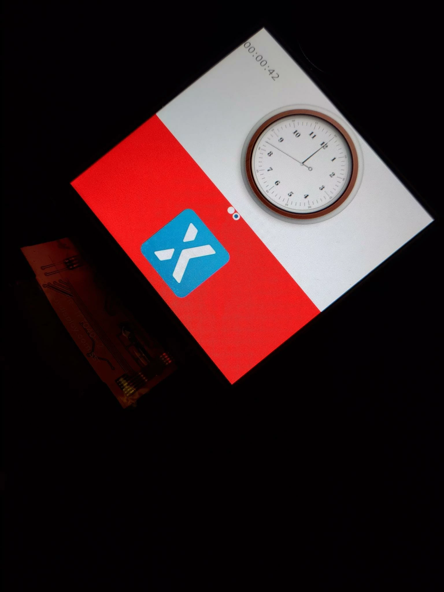

August 13, 2021
Sorry for my late answer I was in holiday, but I have a good news I just finish my tests.
I create from scratch an empty project to use TouchGfx and I don't have any issue.
I make a clock and a swipe zone and I can see any artefact.
I am about 5 ms per frame is really fast.
In this implementation SDRAM is on 32 bits bus size/
Even if it is only single buffer implementation, I can't see anything wrong.
I am on video mode and frame is changed by LTDC interrupt.
I test lot of combination of widgets and I can't see any issue.
To avoid any artefact :
  • Check your sdram frequency and MCU frequency
  • Check your SDRAM bus size
  • Use double buffering
  • Disable caching by using MPU
  • Deactivate speculative cache access to first FMC bank to save FMC bandwidth (FMC_Bank1->BTCR[0] = 0x000030D2; st recommendation)
0693W00000D2SRuQAN.jpg0693W00000D2SRkQAN.jpgBest regards,
