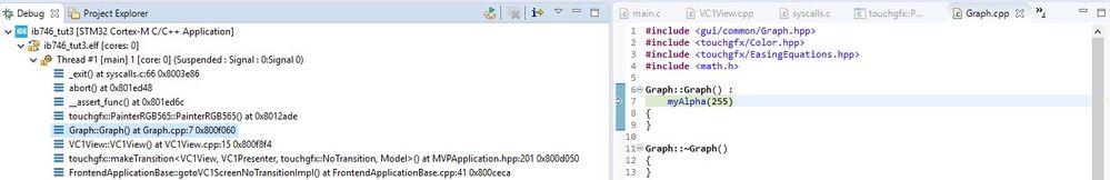

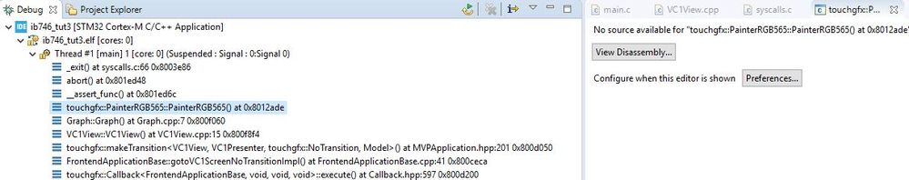

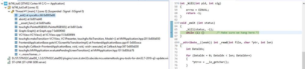

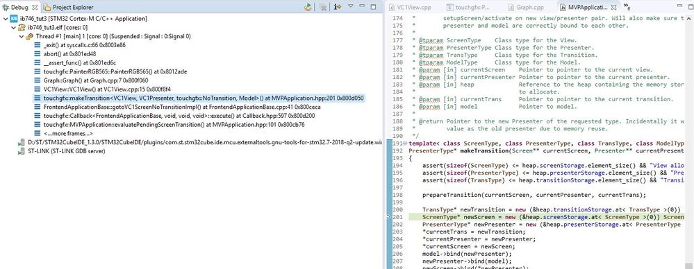

Hi @Martin KJELDSEN​
Thank you for reply.
Very good point on modifying "generated" files, at this point I just want to get it running.
here the screen shot from debugger when application ""crashed"
Tracing it back:
While was typing I was thinking should I place any canvases or any other "UI elements" on screen while generating tuch GFX project?
Anything else I can provide you with? Please advise...
Thank you for all the support
Regards,
IB
‎2020-04-14 10:46 PM
Hi
Did you adapt the painter to your system?
I had a similar behaviour and then I changed from PainterRGB565 to PainterRGB888 in Graph.hpp.
It depends on your TouchGFX settings which painter class to use.
Regards
Dejan
‎2020-04-14 11:26 PM
This is also a very good point. The LCD class will assert if the format is not correct. People tend to copy the Graph from project to project without considering the pixel format.
/Martin
