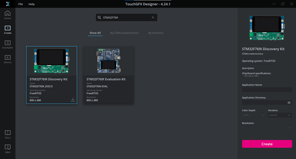

Besides being able to turn on all the pixels, can you display simple data (like a static color) before combining it with a TouchGFX project?
If you are capable of displaying a simple color, then I suggest drawing inspiration from the TouchGFX Board Setup (TBS) available for STM32F769I Discovery Kit since it is also using MIPI DSI display.
TBS for STM32F769I Discovery Kit
Don't hesitate to ask more questions!
