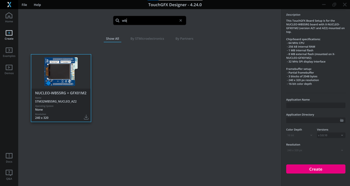

2024-07-10 4:55 AM
Hello @wow ,
I can see that UC8253 supports SPI, which is supported by TouchGFX. However, it is a bit tricky to set it up and get it running with TouchGFX because it requires some manual coding. But, there is plenty of documentation that can guide you through the process. I will list them below:
- Setting up the display using internal RAM
- Enabling TouchGFX Generator
- Display Configuration for TouchGFX Generator
- setting up SPI
In addition, you can draw inspiration from the available TouchGFX Board Setups for NUCLEO-WB55RG or NUCLEO-G071RB since they are configured to use SPI display interface.
NUCLEO-WB55RG TBS
I hope I have answered your question. Don't hesitate to ask more!
