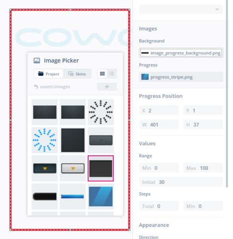

If you select the project folder in the "imageProgress" function, it works normally, but if you select the image in the skin folder, an error occurs.
PC simulation works normally, but an error occurs only in the target board download.

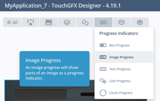

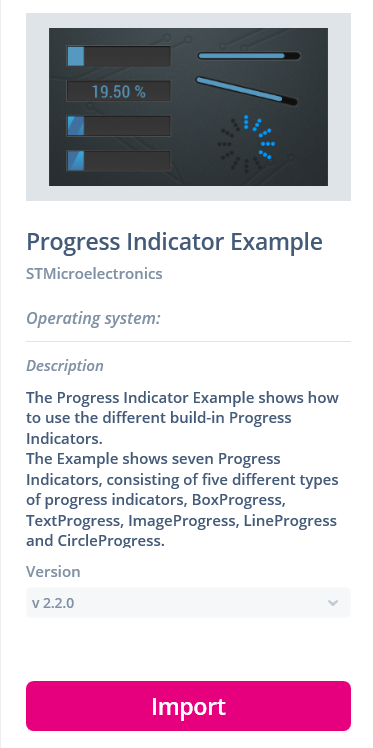

I am studying while watching "Progress Indicator Example" during the TouchGFX demo.
While studying, the above error occurred while using "Image Peogress" in the project I made.

  • TouGFX Demo operates normally no matter where you select the image of "Image Progress" from "Project" or "skins".
  • If I select the image of "Image Progress" of my project in "Project", it works normally, but when I select it in "skins", an error occurs.
