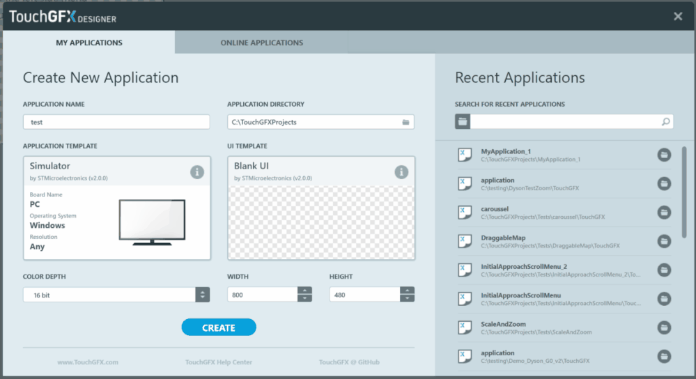

Romain DIELEMAN
As @LTimm.1 said Visual Studio is only used for the simulator, the issue you have on line 261 is not linked to the target. We use IDE like IAR or keil.
Could you give us more details and information on what you are doing? Do you use the STM32f746G disco board? If yes, did you create a project with the given application template on Designer for that specific board?
I am using STM32F746NGH6 Board.
I have created the specific project in TouchGFX Designer, sucessfully flashed it on the device and was able to transmit data using UART.
Since the flashing process (including compiling the GUI etc.) in TouchGFX takes way too long, I aimed changing to Visual Studio since it's able to integrate the Debugger "ST-Link V2" and giving me the possibility of flashing the device directly.
Please correct me if being wrong.
TouchGFX designer uses make to build with arm-gcc for its Application Templates when you click "Run target". But the visual studio projects also in the Application Templates are simulator only by default (Hence why you're seeing SDL references).
"Simple DirectMedia Layer is a cross-platform development library designed to provide low level access to audio, keyboard, mouse, joystick, and graphics hardware via OpenGL and Direct3D"
If you want to use Visual Studio for some sort of cross-platform arm-gcc compilation with visualGDB support then you have to do some work - It's not something that comes supported out of the box. In this case we'd just suggest CubeIDE, i think (The STM32F746-DISCO V3 template supports it).

when you create a project in TouchGFX Designer, select the right application template directly for that mcu. When you will create your project and generate code, all the configuration will be done automatically for you for this board.
0690X00000DXBjtQAH.gif You then do not have to create from scratch a project in STM32CubeIDE, you just need to adapt it to what you have.
