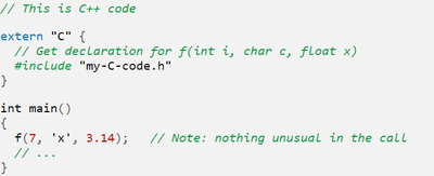

Hello, I am having problems adding my library to my project. I added the .h file to Core/Inc and my .c file to Core/Src. I included the .h in Model.cpp since that is where I want to use it. I can use the definitions that are in my header file but not the functions. I think it is not able to properly link with the .c file and I do not know how to fix it.
C:/TouchGFXProjects/test/TouchGFX/gui/src/model/Model.cpp:46: undefined reference to `i2c_master_write(unsigned char*, unsigned long)'

Calling a C function from C++ code requires the function to have extern "C" linkage, see https://en.cppreference.com/w/cpp/language/language_linkage and HAL header files.
hth

I did

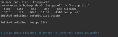

you need to add the extern "c" before you include your header i have tested it and it works fine this is illustrated in the picture bellow you can check this link for more details about mixing c and c++ you will also find a screenshot of the template project  with extern "c" addition

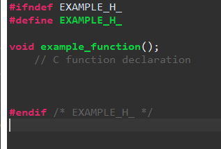

example.h

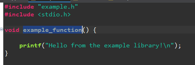

example.c
